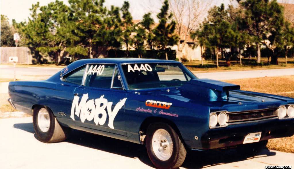

I am sure that is the case for MOST of us. The 2 door coupes and especially the 2 door sedans are typically NOT pretty cars. Some of the very early 60s Mopars have a face only a mother could love. My 66 2 door sedan Hemi car is not nearly as sharp looking as a the sleek 2 door hardtop 500.
The difference is what they stand for in terms of what people remember as the winners at the dragstrip back in the day.
Drag racers were not so interested in how they looked. They were not entering a bueaty contest but rather a race. Most were working class stiffs just racing on the weekends and had little to no backing. If they were lucky enough to be able to buy a new car for racing only or even possibly transportation as well and were serious racers, they bought the cheaper, lighter, stonger sedans.
Anyone that has expressed an interest in my car always comments on the fact that's what they remember seeing winning the races.
