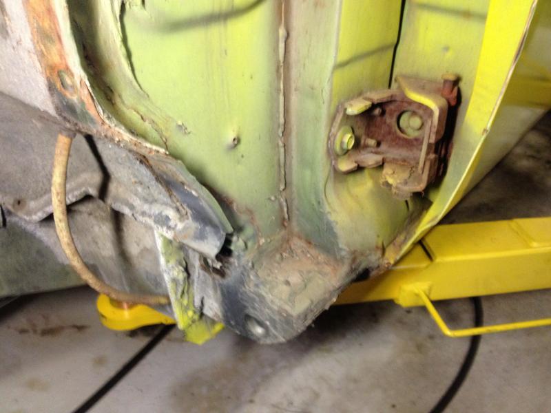

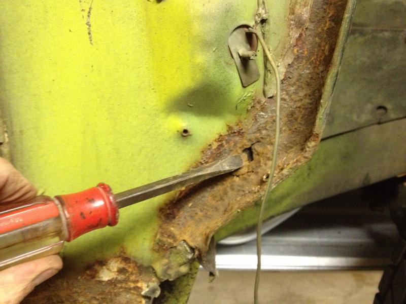

And to add to this, there is seam sealer on the side of the cowl under the cowl drains, and it was usually done poorly when the cars were built. On my car, the seam sealer on one side was put in so that it actually captured water and directed it between the seam sealer and the body. You can see it in the attached picture of my passenger side area under the cowl drains. I would take off the rear splash shields and check this area with a flashlight and mirror to ensure it is in good shape...

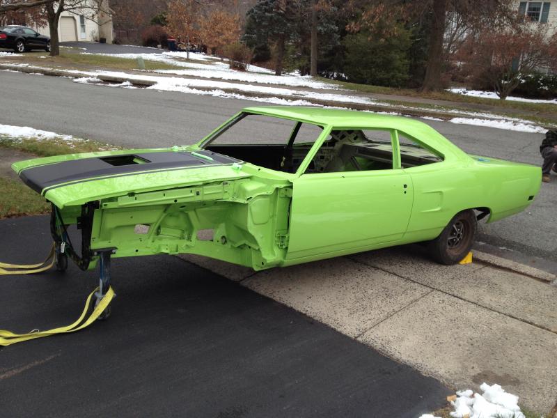

Easiest way to remove the splash shields on a car that was painted while assembled? A pic of the area in question would help also! Hsorman... The pic helps but can't see what your referring to? Not sure what I'm looking at!

Dane,
This is the area just in front of the doors - The backs of the fenders cover this area up.
Here is another shot of the driver's side. You can see the bottom door hinge here...
Here is a picture of my car after the bodywork. The area I am talking about is just in front of the doors. If you look closely, you will see the cowl drain in this picture. Look straight forward from the upper hinge until you get to a black oval hole. This is the cowl drain...

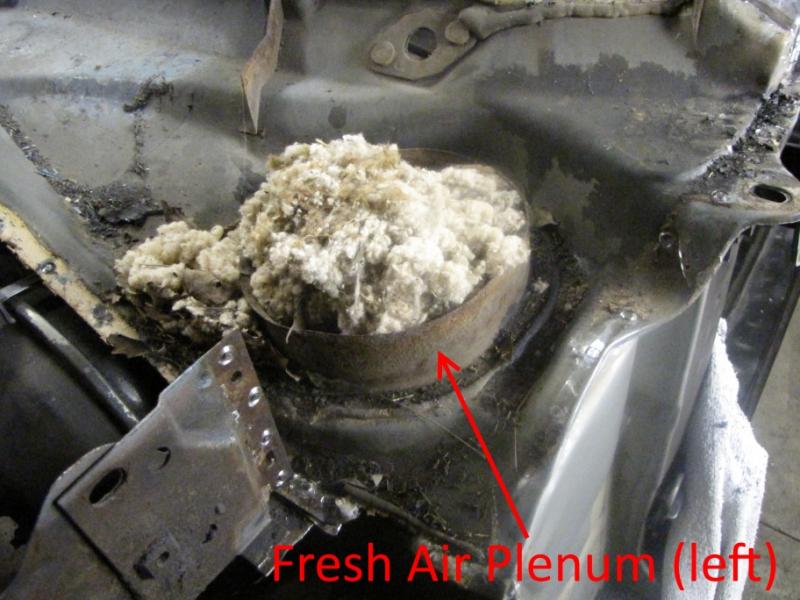

Where is the water leaking at? Is it sporadically across the floor or does it leak in specific locations? Good way to troubleshoot the leaks is to just lay a hose on the roof, let the water run down the windshield and observe from inside the car. Windshield seals and wiper pivot seals are usually the culprit, but unfortunately there is a darker, deadlier cancer that our B-Bodies can have an issue with as well.........The inner cowl fresh air plenum's. Their located at the top of your fresh air vent boxes. Typically what happens is dust, dirt, leaves, mice nest's, pine needles drop in the cowl through the cowl vent slots. From there that garbage settle's around the lowest point inside your cowl, and you guessed it, right at the fresh air plenum's. After the years go by rust set's in and it rot's away the plenums and surrounding metal. When that happens, water goes down inside the cowl vent openings and run's right down inside the car's fresh air vent boxes and on to your floorboards. Bad new's! The real bad new's is that to properly fix them, the outer cowl needs to be removed to gain access, and obviously that's no walk in the park. I've seen other guys just seal them off from the inside of the car, but then they have no fresh air vent and no outside air making it to the heater box/ac as well.
If you need to inspect your plenum's, you can remove the driver side fresh air box pretty easily. Inspect the rubber boot/seal at the top of it. With a mirror/flashlight you can inspect the condition of you plenum.
The above pic is not a big bowl of nasty-*** popcorn sitting around since 1984. It's a mouse nest filled plenum. Amazingly this plenum on my 69 roadrunner was not rotted through, but the pic should show you what a poor design this is for longevity (being all the garbage & moisture is funneled right to it.) Unfortunately my '68 coronet did not fare as well and I routed for a bit more work, but a bit more drier feet.

Wow! Great reply! I actually removed the air box and splash shields to access the drains. The plenum appears to be in great shape but there was sand (from sandblasting I assume) packed to the rim. I cleaned out all of the sand through the drain and by hand from under the dash. What a job! I'm in ohio so it is too cold to start playing with water. I will try the hose deal though. My first though is that the sand was not helping matters and may have been causing it to overflow
