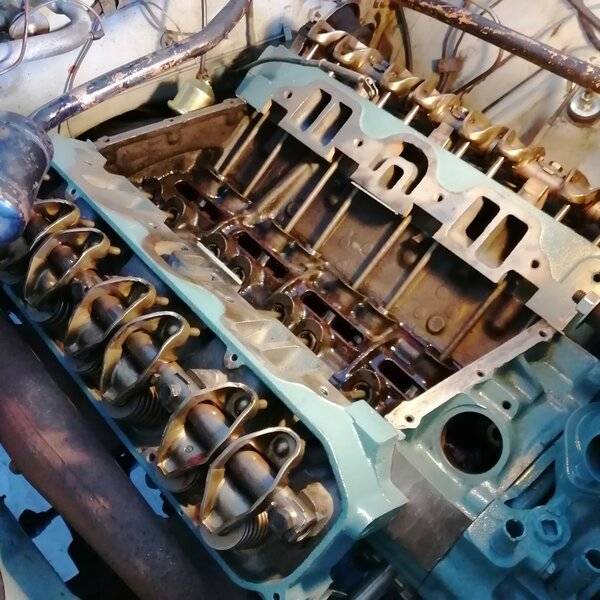

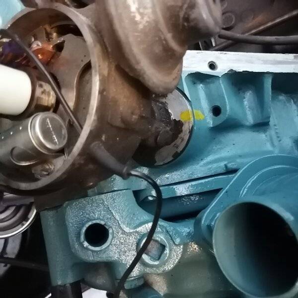

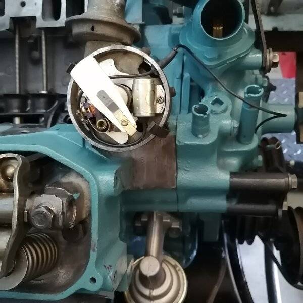

Made some progress this weekend. Primed the engine then installed the distributor gear. First I made sure I was at top dead center on compression. Next I made sure rotor was pointing at number one. I had marked the distributor position before I disassembled it, and everything is lining up correctly. I want this thing to fire up immediately to break in the cam.
Looking great. Your rotor is correct because both #1 lobes are on base circle (firing). make sure all vacuum lines are good, fill the bowls, lighter up!

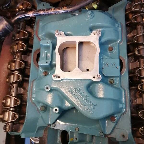

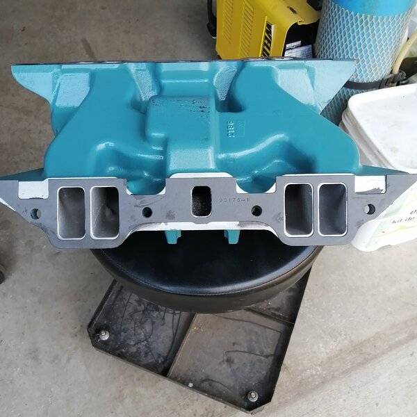

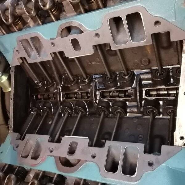

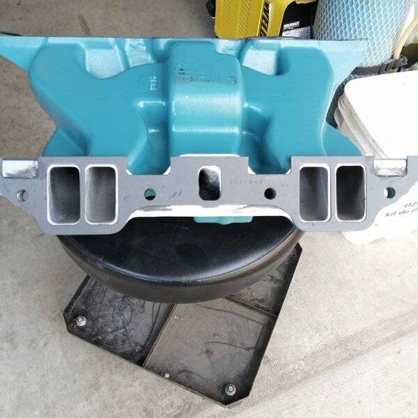

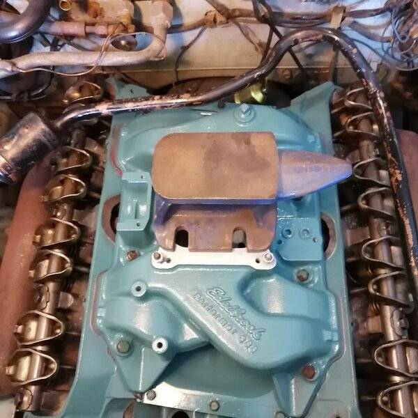

I dry fit everything and figured I could use both paper gaskets on the intake. I had an oil leak on the last engine where I only used one. I was amazed at how close the stock ports were to the gasket size.
I needed a little help to get the intake bolts aligned. It was pretty tight but I got it snugged down. I will be removing the bolts one by one to add the brackets later.

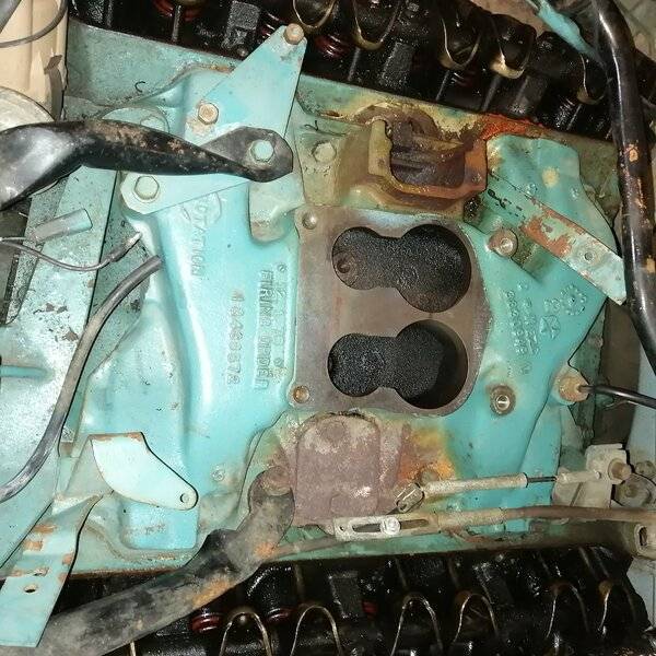

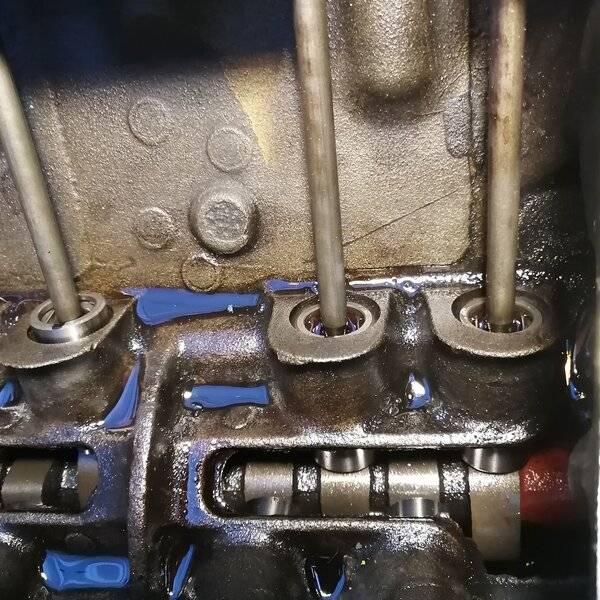

I used the blocked valley pan gasket. I previously removed the heat riser. Also put rtv on the front and back. Hopefully leak free.
Yes I restored my heat riser also. They say I don't need it in Fl. But here guy's say their car's run cold even in hot climates. Figured the guys that built the motor's knew it need it for first start up so I restored mine.
Carb or fuel injection faces the same issue (maybe less for multipoint injection), when the engine is cold the fuel vapor in the air condenses against the cold intake manifold which causes the mixture to become very lean.
The sooner that intake manifold has has some temperature the fuel will stay as vapor suspended in the air and makes it straight to the cylinders.
Mine runs like **** when "cold" but once that intake heats up a bit it runs fine, i am not using the heat riser as the ports in the heads are plugged and unusable but i can manage without.
Don't think blocking off the exhaust through the intake will make that much difference do to the cooling fluids are still running through the motor and will heat up the block that way also. Just don't know if it hurt's that side of the block to have the heat riser on it. Will run it that way. It dose not take long for it to open up just a few minutes. Exhaust is coming out of that side when cranking up the motor. Dose not restrict the exhaust that much. Only time will tell. Any other thought's about this would be grate.
Those exhaust gasses are hot from the start and will heat up the intake itself quickly, this obviously was there to avoid icing on the carb during really cold times.
That heat riser will have the intake warm before the cooling system gets warm.
Have not had a heat riser on a musle car since 1975, and I've lived in MI, OH, and PA. My daily driver, when I lived in MI, did not have one.
