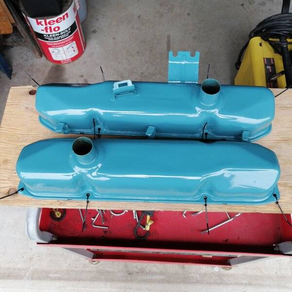

Got the FelPro high heat gaskets in the valve covers. They have no ears so I had to zip tie them until the sealer set up. Installed them and touched up the paint and it is starting to look like an engine again.

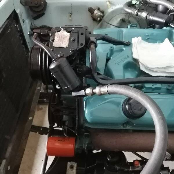

It's crazy how different the paint photographs in different light. The engine bay shot is the true colour.

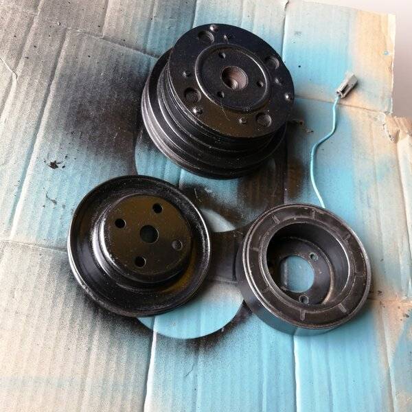

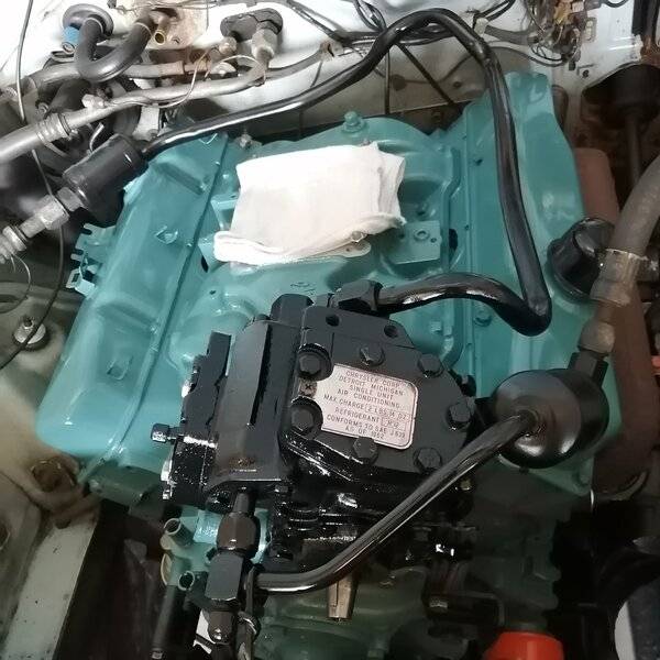

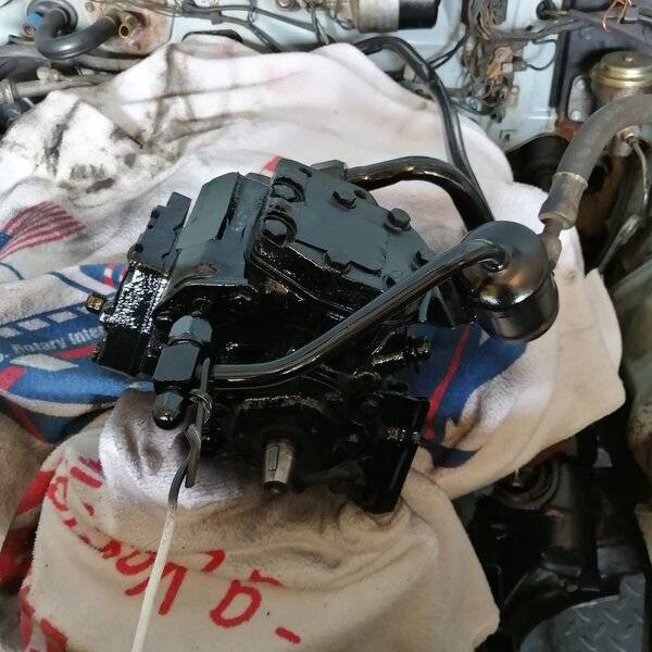

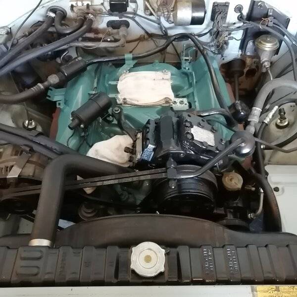

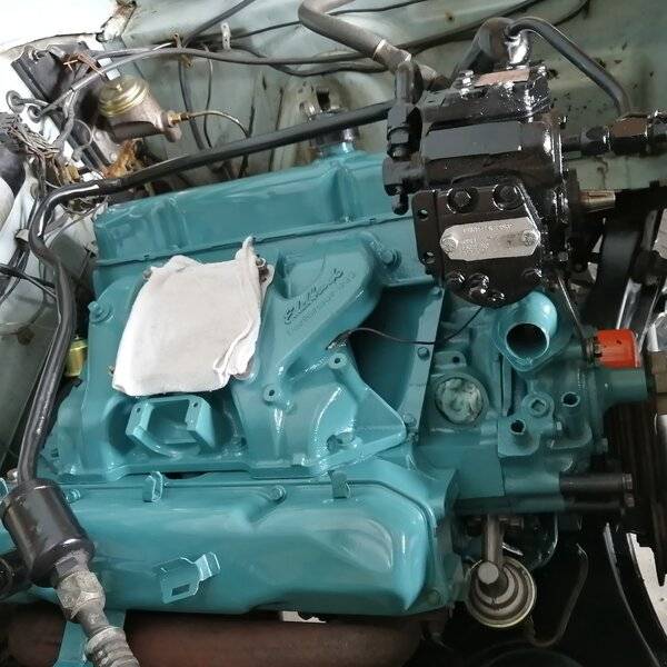

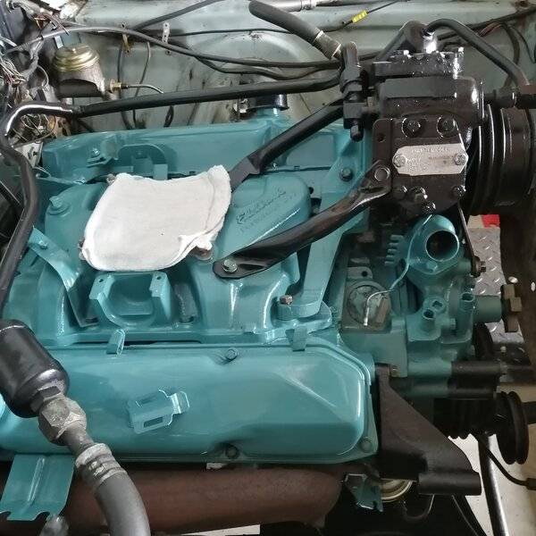

More cleaning and painting this weekend. Managed to clean the A/C compressor pretty well in place. I love using old towels to mask around irregular shapes. Worked out pretty nice.

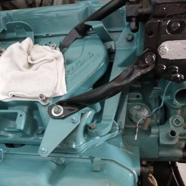

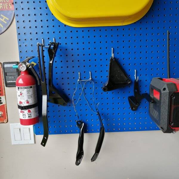

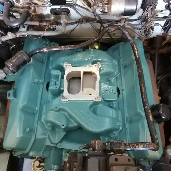

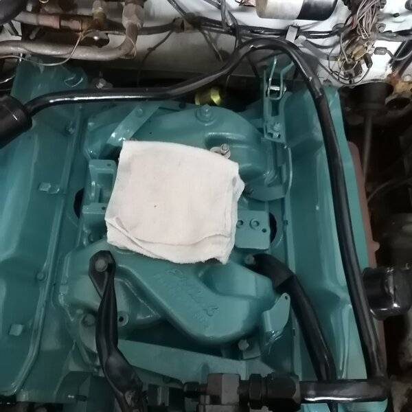

Got a bunch of bracketry installed but found out I have some fitment issues to solve.

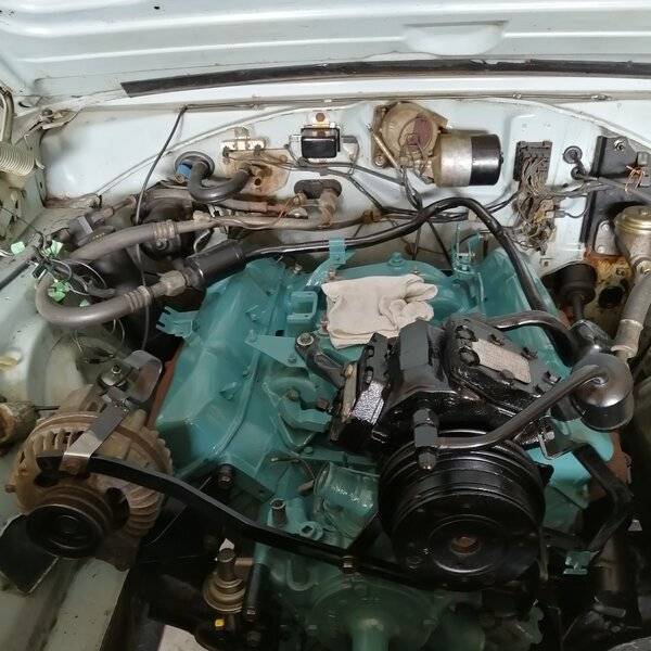

Got a couple of problems solved. The drivers side compressor support just needed the holes enlarged to 1/2 inch to get everything to line up. The coil bracket wouldn't work because the front manifold boss was higher and interfered with the passenger compressor support. A little bending and cutting and problem solved. I also got the alternator installed. I still need to pick up a socket head bolt for the drivers side under the return spring bracket, because there is no room to get a socket or wrench on it.

Got quite a bit done this weekend. All belts and hoses are on and cooling system has been filled. Distributor is in and wiring is hooked up. Basically just needs plugs, cap and wires and fuel lines and carb.
