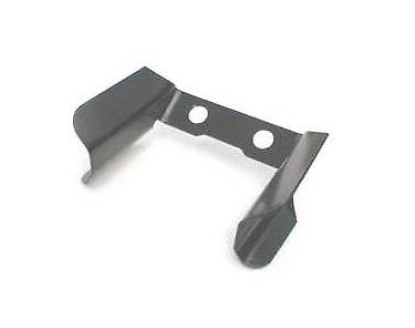

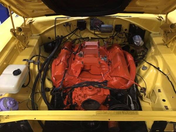

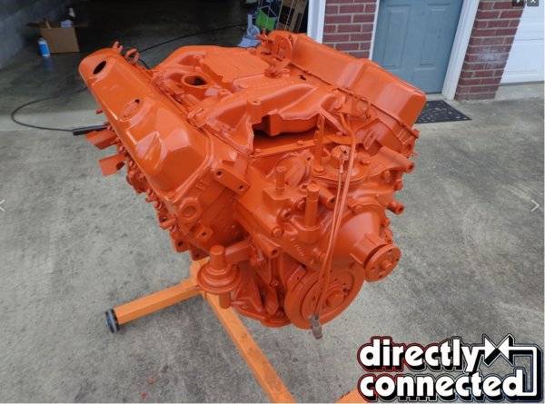

The engine builder of my 69 Chargers 383 didn't install spark plug brackets or heat shields. I am wondering if I can remove a head bolt without unsealing the head. Do I need to remove the heads to get these installed or can I short cut it?

Typically the heat shields are connected to the front/rear end studs of the exhaust manifold.
They are held by the head bolts
Personally I wouldn't (and didn't) put them back on

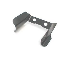

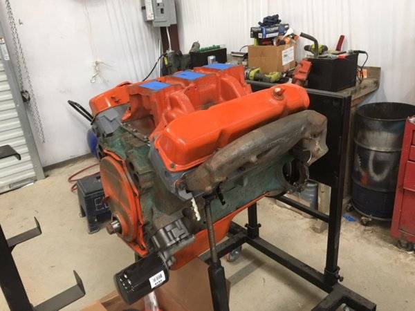

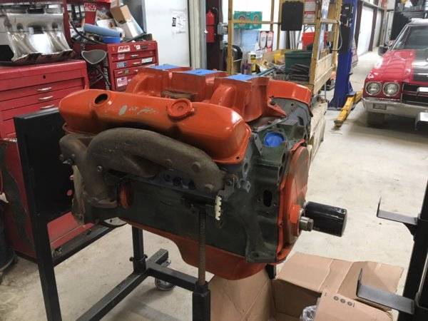

Anybody have a completed picture of this? Because I don't believe I've ever seen anything held on by head bolts (other than the head). How would you get a good seal on the head gasket if something was running under or over it?

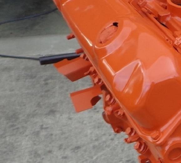

Sure plenty of cars used the under head bolt heat shields for the plug wires.
Granted, I am viewing from my phone, but those appear to be attached by exhaust manifold bolts, not head bolts.
You would be incorrect for some and correct for others.
Once you are around Mopars long enough youll get the hang of it brother.
