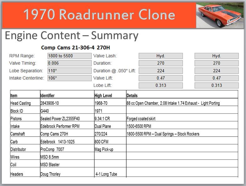

Some Background: 70 Belvedere, 440 with essentailly a 6-pack grind cam, 9.3:1 compression, eddy performer intake and carb. Assume 3.23 gear (although not yet purchased). A cruiser, not a high peformance machine.
