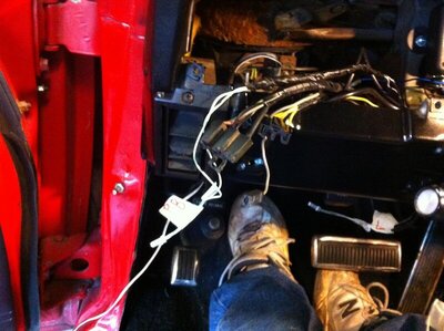

All the wiring was identified and marked for quick reference.
All those masking tape tags are still in place. It is faster than having toi look at the wiring diagram every time.

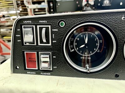

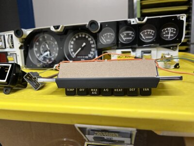

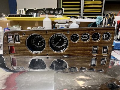

Good work. If you want to return to the beautiful factory look with excellent function of factory restored parts, please look up my services. I specialize in restoration of Original/factory installed gauges, switches with upgrades of quartz clock, solid state tach board and voltage limiter. When restored correctly, they not only look absolutely stunning, but they function as intended. I also specialize in ac vents and controller.
