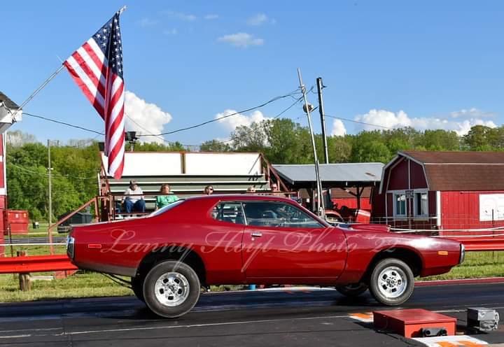

Yeh, and I guess that's what they are supposed to do. Just maybe need to control it better.I don't know anything about Caltracs, and I'm an idiot. To me it looks like the old MP SS springs pushing the axle into the ground.
unloading the tires?!? Looks like you got air time! Ya I would move the springs up. And cal tracs want all the front end movement you can get. Lower the front into the weeds.View attachment 1286087 Here's a picture just a few feet out.
Looks like too much separation in the rear, maybe unloading the tires.
I have the front spring mount in the lower hole, perhaps I should move it up?

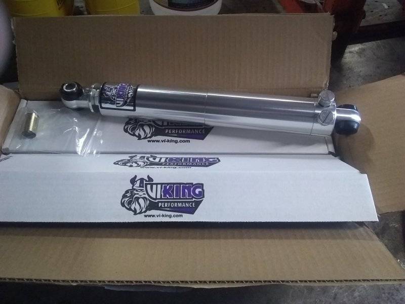

Nice fix.Front shocks are difficult in 73. Stock they are too short...Nobody makes any. I fabbed up a bracket and welded it to the upper shock mount to extend the shock length up about an inch. Now I can run a shock that's available. (Chevelle, I think)
