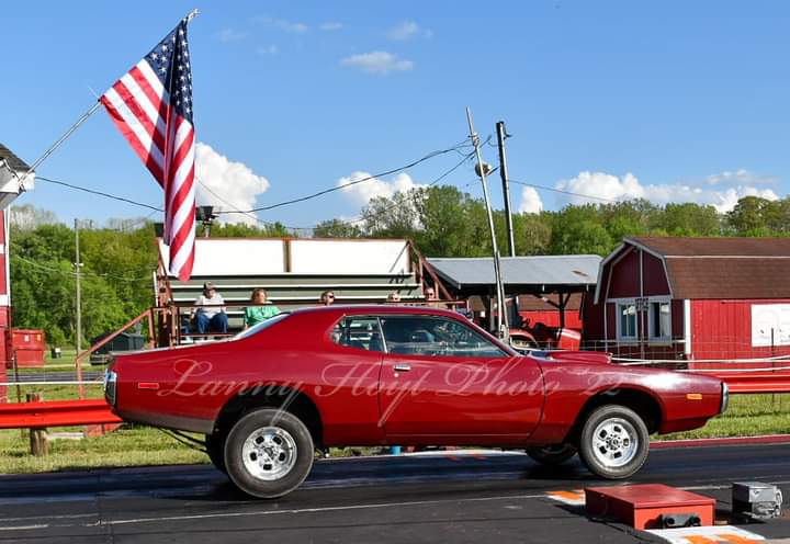

Sorry for the late reply. You need to clamp the rear half of the springs. This was a common problem in '70's. I moved my clamps to a couple places to get the springs under control. I also built my leaf spring package work for my car. The leaf springs and shock combination need to work together.View attachment 1286087 Here's a picture just a few feet out.
Looks like too much separation in the rear, maybe unloading the tires.
I have the front spring mount in the lower hole, perhaps I should move it up?
