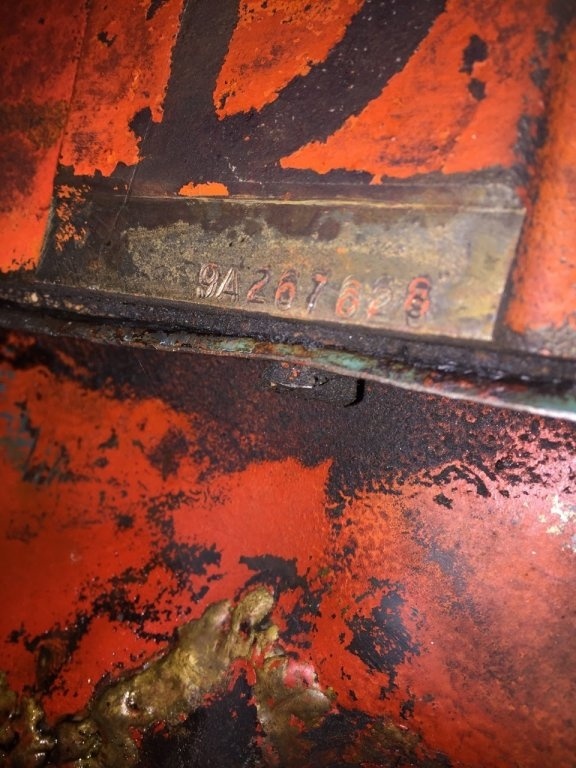

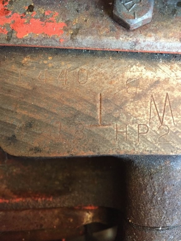

I have an opportunity to buy this block. He says it's out of an A12 RR. This is the vin#
Is it possible? It's complete except the intake and flywheel. What's the most I should pay for it?

View attachment 407401 View attachment 407402 I have an opportunity to buy this block. He says it's out of an A12 RR. This is the vin#
A 207 VIN is way too early to be from an A12 car. The earliest A12 RR VINs are in the 246 range. The approximate SPD for that VIN would be about 110. That's likely at least 3 months ahead of an A12 with a 426 SPD.
A 267 VIN would be out of a Belvedere based car meaning it's out of a GTX or A12 RR. Approximate SPD of 506.
