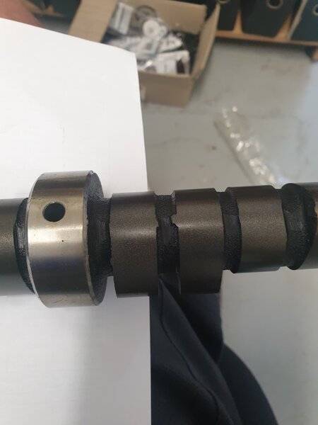

Defective NEW camshaft. Ever seen one like this?

I think the issues are with the casting itself, based on what I see, and Comps does not "make" camshafts, just grinds them. It is their supplier, and their QA/QC department, so I'm not giving them a pass, or saying it is okay. Some guy at Comp decided that this was a good enough product for the customer and that is a management problem. I think they could dress the sides without adding much cost.

Seems like they skipped the final machining run to make a smooth surface and de-bur the edges to save money.
You would expect that QC takes that out as it does not meet the standards.

Maybe I'm the only one? But I've seen worse issues than casting flash on other brands, like out-of-spec journals or lobe taper. Those are instant go-backs in my book. Casting flash is easy to remedy with a fine file or die grinder, but to be clear I'm not saying it's okay to send them out like that. You won't hurt the surface; be easy, file down at an angle towards the core. Really, the lifter doesn't ride directly on the edge of the lobe anyway. You can't have anything sticking 'up' is all.
The dangerous stuff is the casting flash between lobes, and may stick up higher than the lowest part/ base circle of a lobe.

Just think if the novice would use that cam. It would probably have destroyed everything.

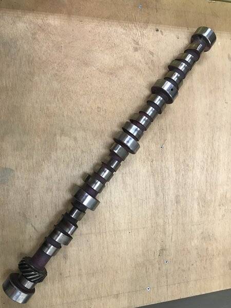

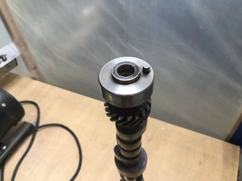

View attachment 1012073 View attachment 1012074 View attachment 1012075
No numbers present that I can see. All the lobe and bearing surfaces are fine, no signs of ugliness. Lift is around .320, no idea what lobe separation or duration it has
.320 x 1.5 works out to .480 lift. It could be either the 280/474 or the 284/484.
I thought at the back end, all cams got some type of identifying numbers. It does have the purple paint on it.
I ran the 284/484 in a 440 and wasn't as impressed as I was with the 280/474.
I have a 280/474 in my 383 car w/ a 4 spd & 3.91. I like it a lot for my combination. Its got a little attitude and idle. If your compression is lower and you are surrounding the engine with stock stuff, a little less cam than the MP 280 might be right for you. The 280 is more cam than Comp's 270.

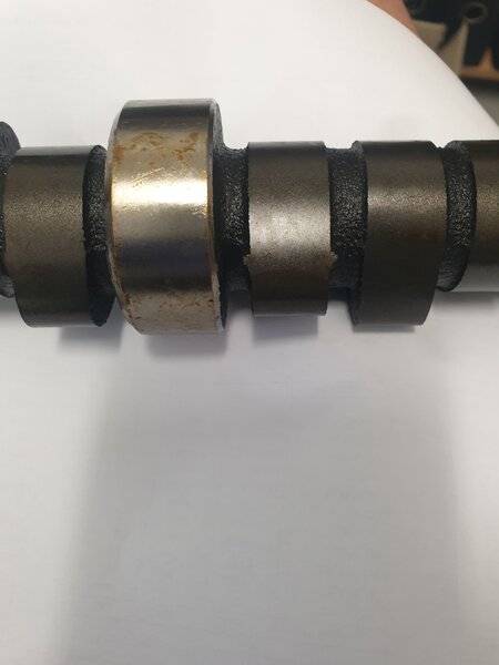

I've been inspecting my new cam since I saw this thread, and never having changed one before I'm not sure if these casting pieces are normal? They are flat (in line with the lobe) and are on most lobes, but are only prominent on some depending on the rotation of the lobe. What do you think - is it ok? It's a Schneider cam.
Well with no opinions on the quality I think I'll use my dremel to carefully clean off these pieces and hope for the best. Comparing the photos of my cam and the dodgy one Kern Dog got, I'm a bit worried as there seems to be some similarities, but from doing some Google research it seems to be fairly common too. A bit confusing. Maybe I'll take it over to a local engine builder for his opnion. I thought camshafts, being such a precision item would be ready to go "out of the box".
Nothing wrong with that as long as nothing sticks up above the lobe. Not pretty; but doesn't hurt anything.
Yeah, that is what I'd say. It doesn't look like anything but casting sloppiness but since the grind of the lobe is even, I'd use it as is. Mine looked like a narrow strip of grass left UNmowed in the yard.
