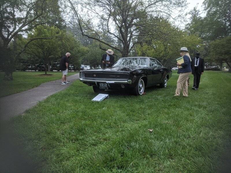

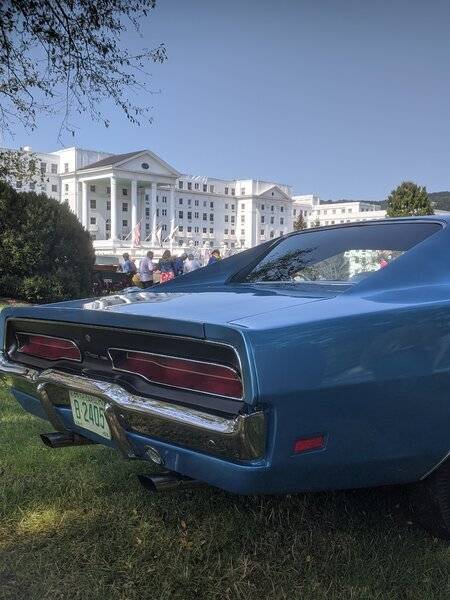

I posted this else where but I drove the 69 to the Greenbrier Concours with the family. No Ribbons but had a great time. There was a 68 accepted as well.
When I got there and was trying to find out where to park overnight. I was told I should park in my trailer. They were quite surprised to learn I didn't have a trailer and drove it the 200+ miles

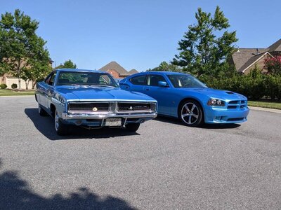

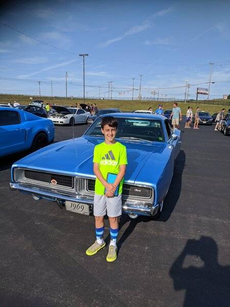

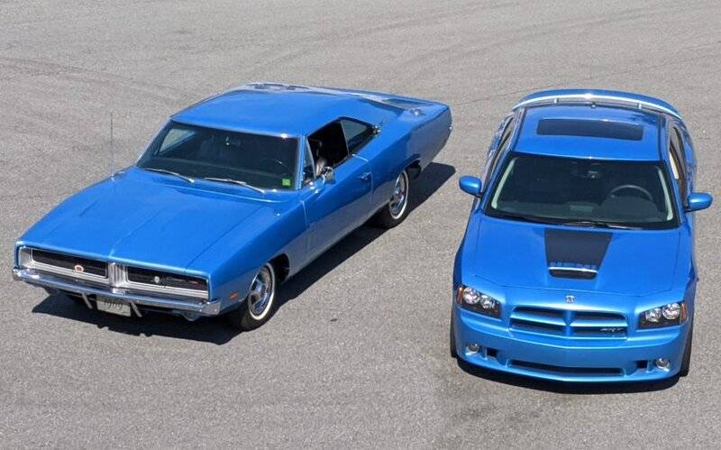

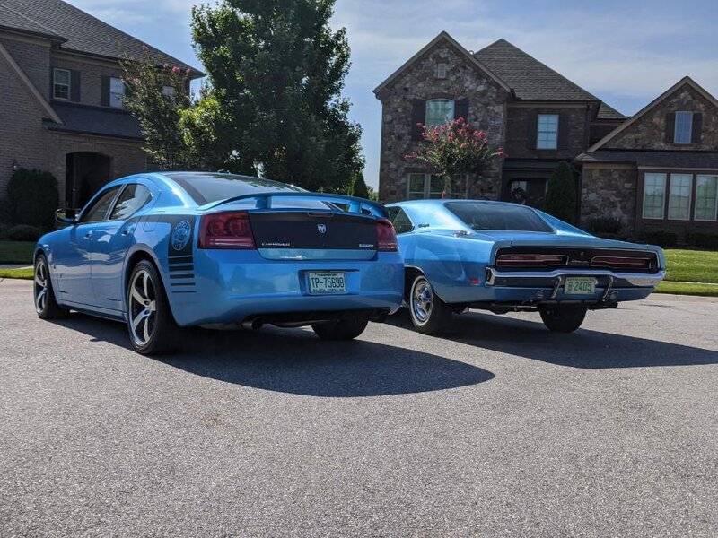

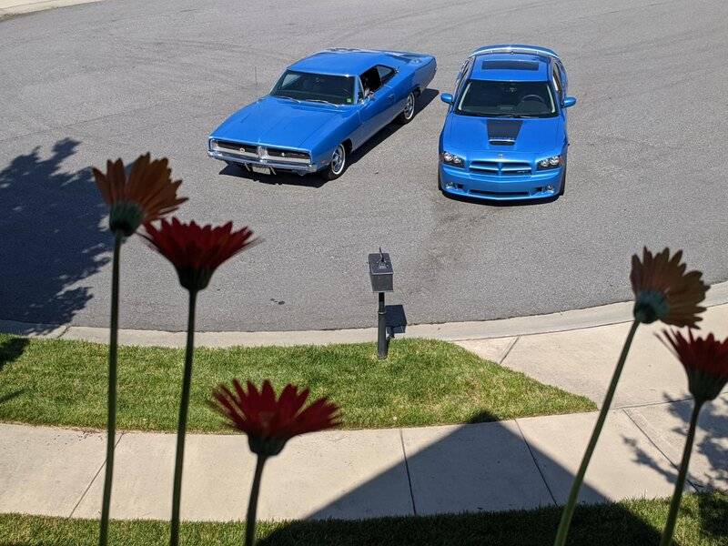

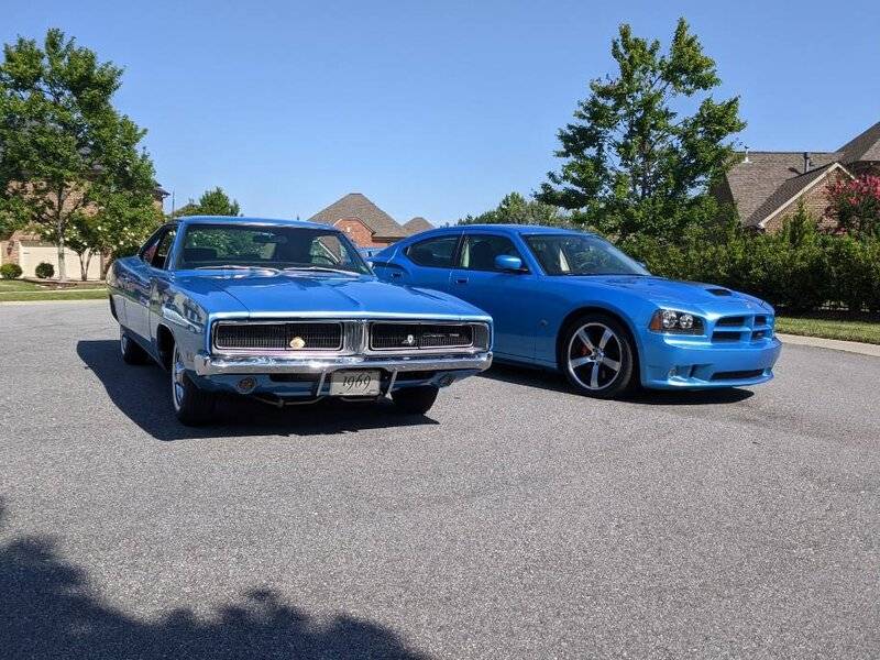

Today I went to cars and coffee with my partner in crime who claims this car as his.

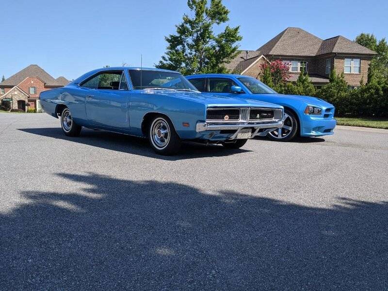

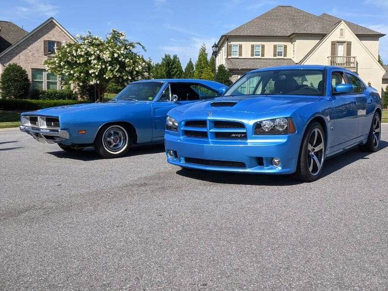

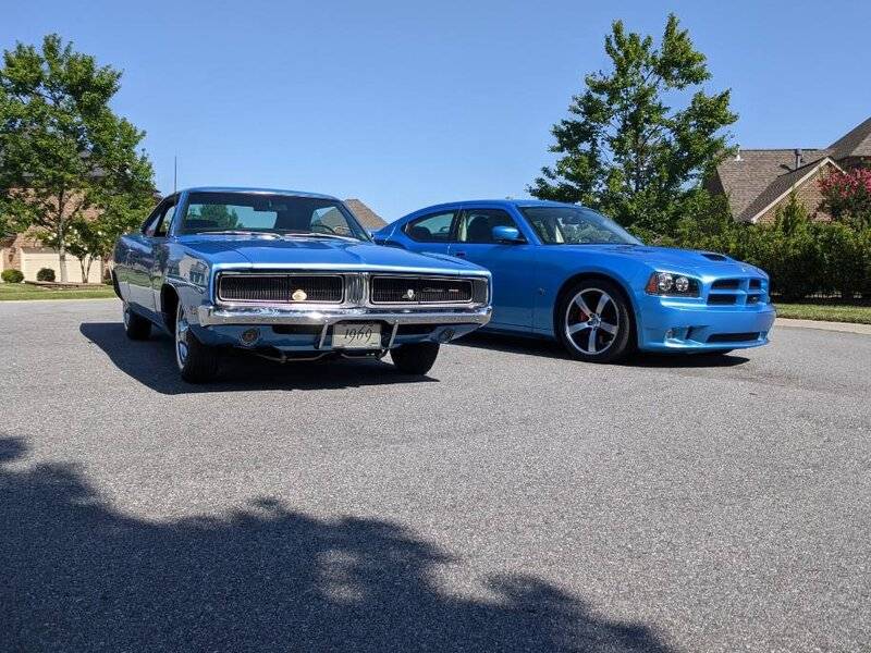

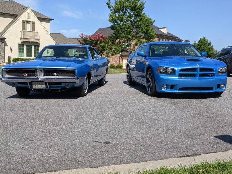

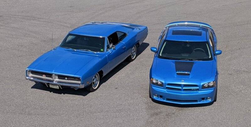

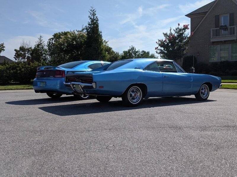

And since I had the one Charger out and I am going to be putting the other in storage so I can begin a restoration on a 1938 Buick Roadmaster model 87 (one of 6 left know to exist of 466 produced) I decided to get these since I had yet to photograph them together.

What brand and size tires are you running? I like the thickness of the whitewall.
