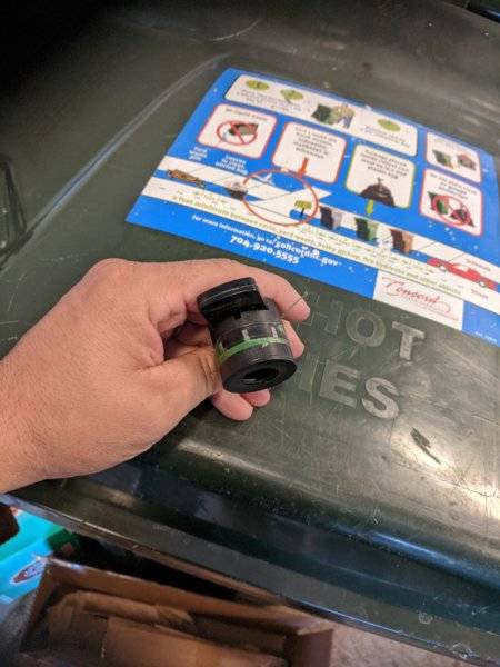

Little concerned that the old rotor looked liked this.
I cannot gap the new pertronix II to 0.030 per the direction. And I feel like the new one is rubbing too. There is some play in the plate. Got to think about this more.

How much side to side play is there on your distributor? If it's making contact with the pickup the bushings are most likely worn.
I love the Pertronix II and III drop in ignitions. You can bypass the ballast resistor as well. Looking very good!

How about the center piece on the distributor where the rotor goes? If that has play it can make contact as it spins with the pickup on the advance plate. Maybe cause erratic ignition as well.
