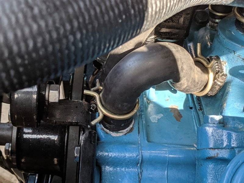

This bypass hose has still been leaking.
I finally put modern clamps on it. When testing it to see if it was still leaking I saw it blowing up like a balloon under load.
I'm afraid it will burst. Why is it doing this? What am I missing?
Some sort of clog?
My brother thinks it maybe the gaskets between the head and the block, causing a restriction.
It's brand new repro
Really, hmm. Even regular rubber heater hose should easily take up to 70 pounds of pressure. The good reinforced silicone hoses are usually rated for up to 200 psi. so if yours is new then I don't know what is happening with your car, sorry.

Looks like your bypass hose has ripples on the radius. Get yourself a Mopar 4012595 pre-formed hose. I have one and it works perfectly and the fit is perfect.
10-4 this was a pre-formed hose,,,, before I blew it up like a angioplasty there were no ripples...

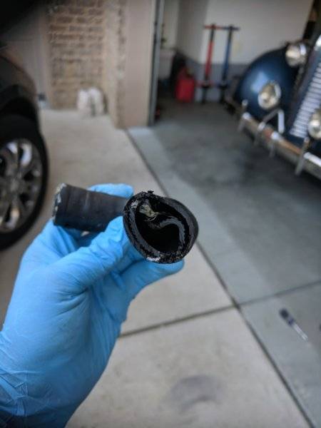

This appears to be the issue with the hose.
It split on the inside....

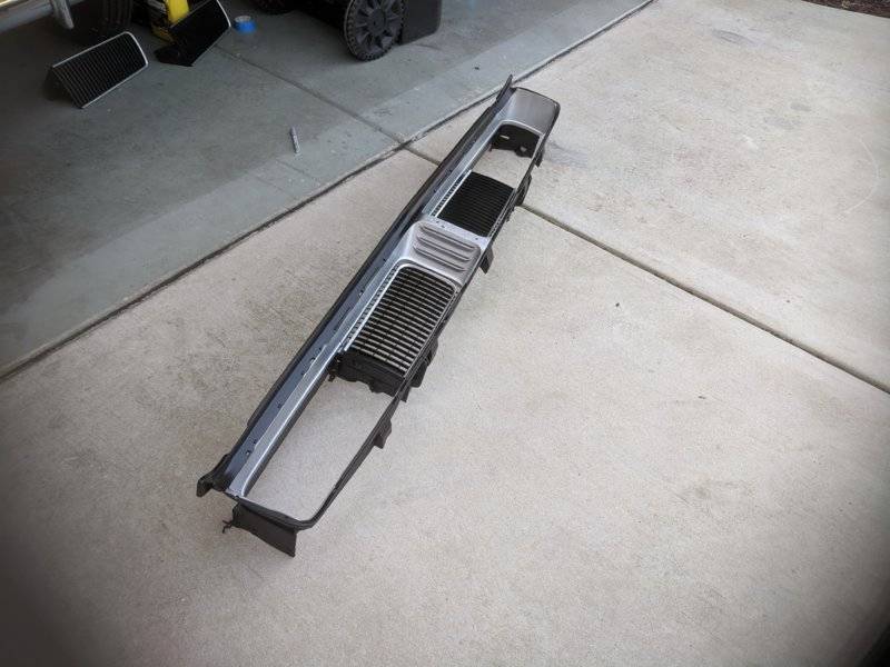

Got the old grill down from the attic. It looks like I'm gonna have to use it for Hershey.
Looks good! It has the same common problems most grills have but very few and is in great condition.

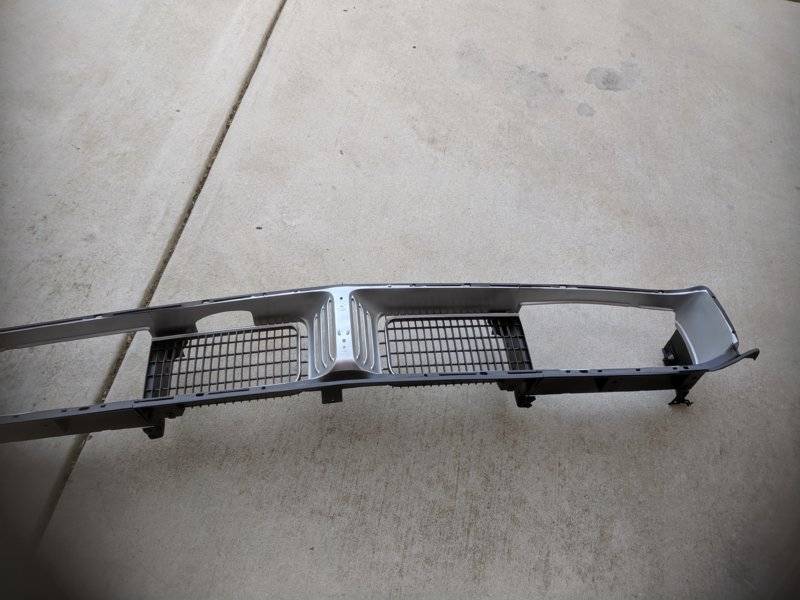

I did get the grill in, sort of, it's not 100% by any means but it will get to and from Hershey.
Car looks great! That grill is in great shape for not being restored.
I did clean it up and paint it, of course and new repro stainless... the pass. side headlight door catches on the frame some, but for AACA judging in Hershey I should be ok if they don't look too hard.

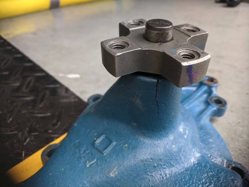

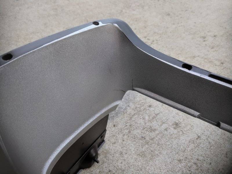

Hershey is next weekend. I got a lot to do. I got the car back yesterday from the paint shop. picked up the kids at school and a significant amount of coolant was dripping from under car. Drove home and with the car running no leak. Turn the car off and Niagara falls. I got under the car and it seems I am leaking from the water pump housing to timing chain cover area on the drives side of the motor. Doesn't seem to be pressure related either so gonna pull the pump tomorrow and try and seal it back up. At this point if I don't have that corrected no Hershey.

Failed in the exact same way as the first one... Maybe due to the bypass hose issue??? Got no other explanation.
Gouged the timing chain cover some.
