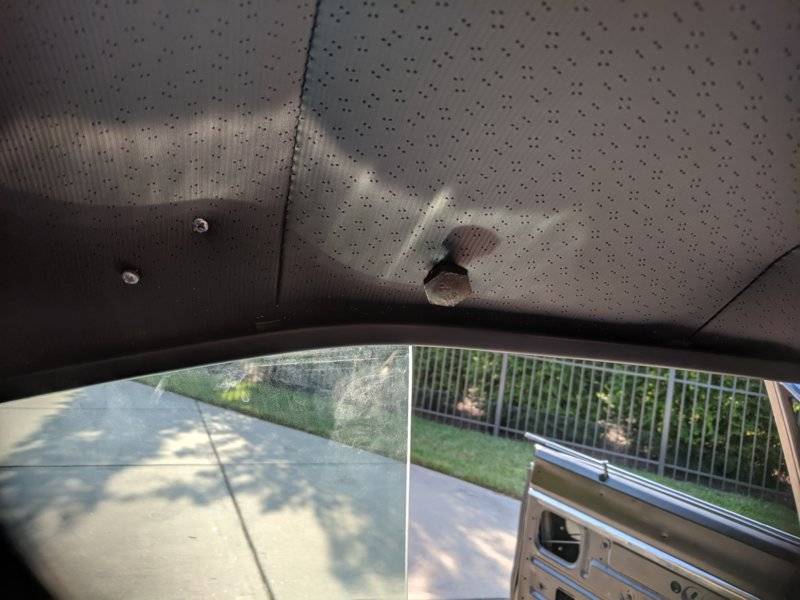

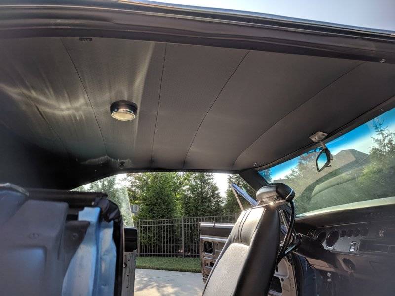

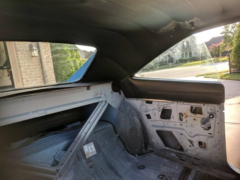

I did get the DS door vent window and side glass in and the car is at the upholstery shop getting the headliner in as we speak. Hoping to have it back Friday so I can do a little interior work this weekend. Also go to get it in to the trans shop and the get an alignment too.
Got the car back from the upholstery shop today.

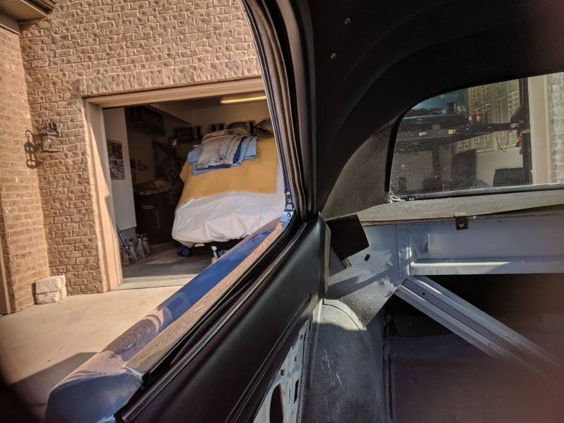

Can't seem to get this one trim rail up where it is supposed to be. Any tips?

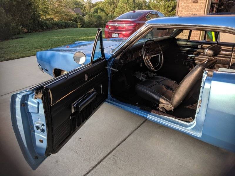

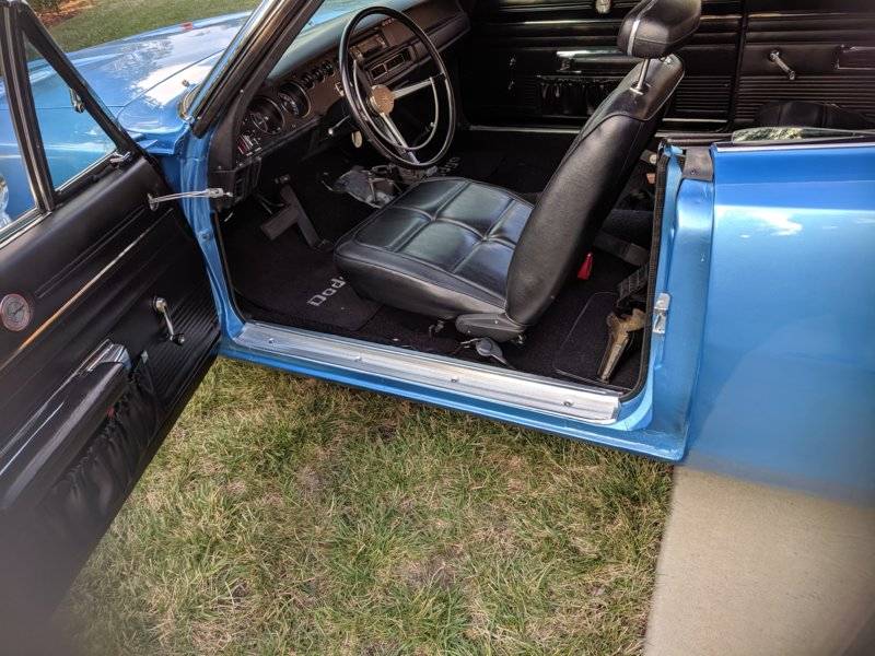

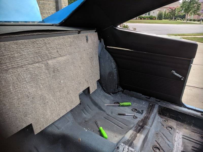

Rear door weather barriers, door panels and seat back in. Thats as far as I got this weekend. Also put the stops on the side windows and adjusted them a bit to fit better.
My car was doing the same. I was guessing that because of all of the re-manufactured parts that I used the trim pieces were now too long. I had to custom fit everything on the interior of my car. Nothing fit how I felt it was supposed to, including these trim parts. I ended up cutting about 1/2" of length off the back of the trim so that it would slide back far enough to clip in. That also helped it fit over my A-pillers better.

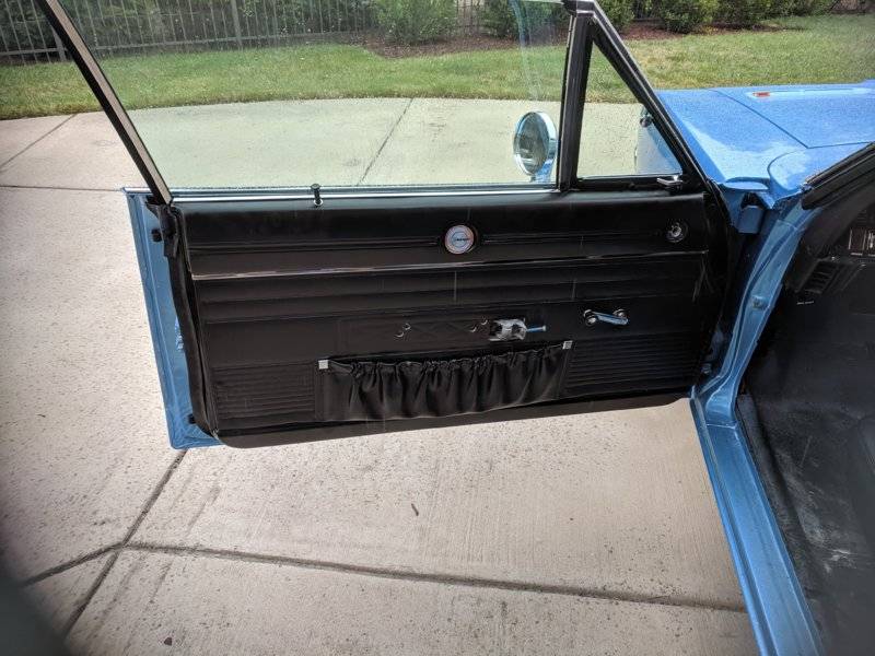

Full day today. Started with weather barriers and door panels. yesterday attempted to get the remote mirror in the upper door pad. That was a disaster end up gluing it in place but then the adjuster came out of the i don't know what it is called and then later you will see the glued piece didn't hold either so gonna have to go back to the drawing board on that one

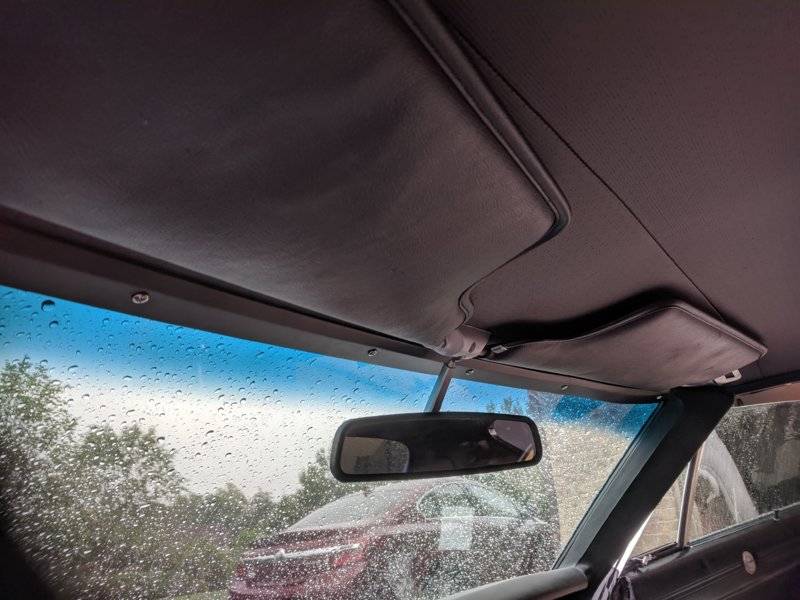

Then sunvisors

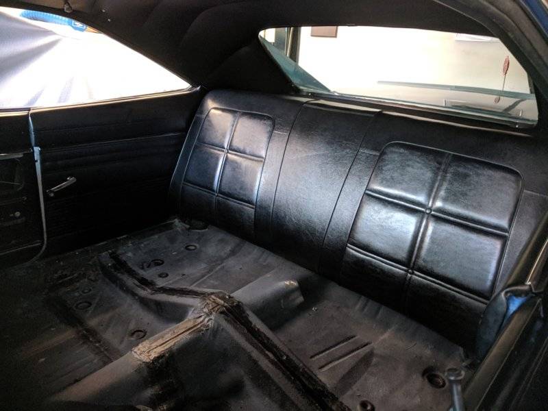

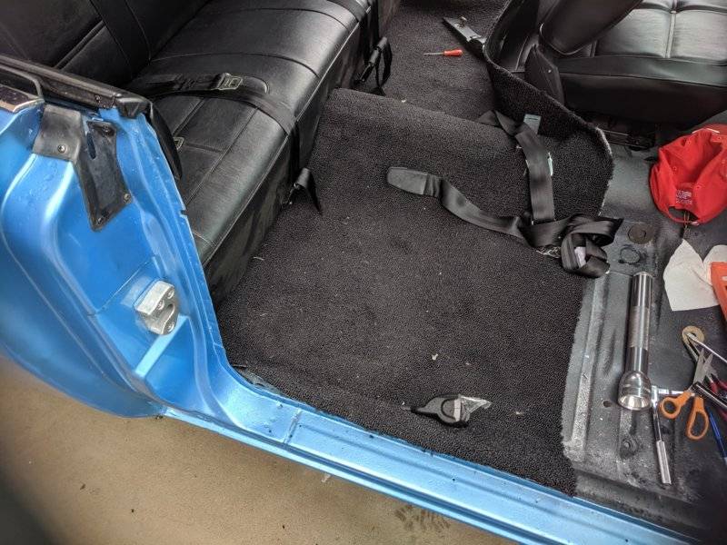

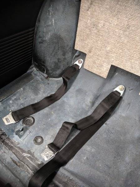

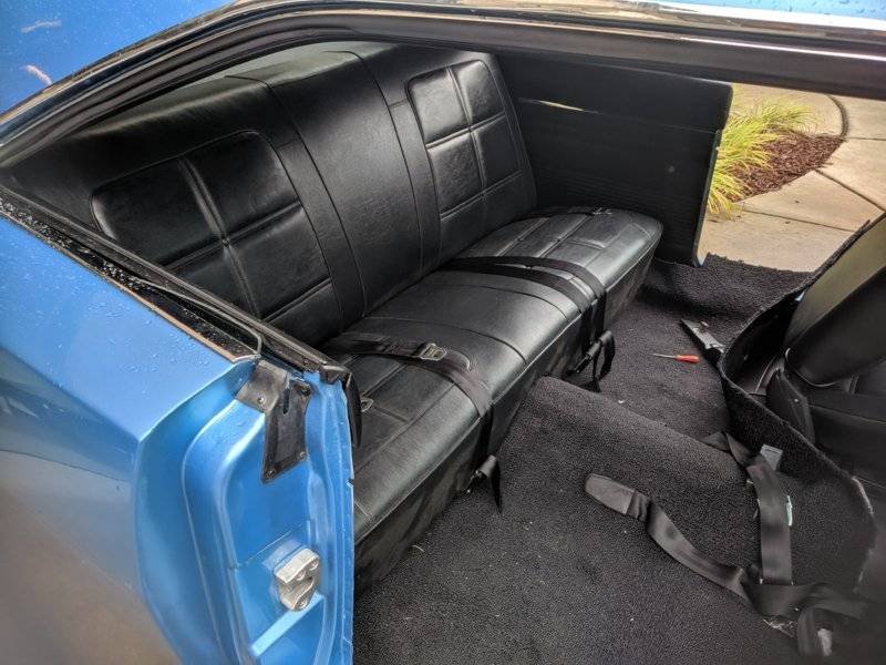

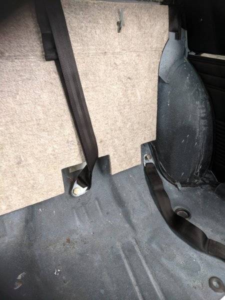

Then moved on to rear seat belts, then rear carpet, then the rear seat and then the rest of the seat belts.
Then moved on to the front carpet

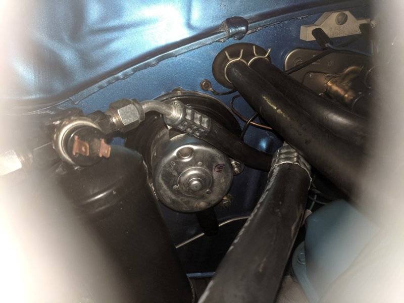

1. replacing the voltage regulator but still have a discharge

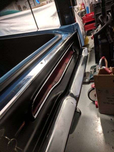

I now have 2 different repro grills on back order...wonder which one will come first. A handful of other parts are on back order too but that is the most obvious towards completion. My replacement tail light bezel is supposed to be on the way too.

Oh and a minor coolant leak has returned from the bypass hose (from the water pump to the t-stat housing ( at the pump only under load)) just gonna put a modern clamp on it and call it a day.

you do have to find humor in the door handle worked fine for months but the day the weather barrier and door panel go on the linkage falls off twice.

I had the same problem trying to hook up my adjustable mirror. The new upper door panel was too thick and the threaded adjuster was too short. I carefully pulled up the vinyl around the hole and removed the extra fill that was extruded under the vinyl then I carefully hammered the metal in so that it would be closer to the door frame when installed. I struggled for a while until I could get the threads to catch and pull everything together.

Yeah i already tried that cutting the vinyl and padding away and still couldn't get it to catch. I hammered... i cursed, a LOT... i but the trim ring on backwards to get it to suck in closer and hopefully hold, it didn't. Finally I went to epoxy... that's when the adjuster fell out of the threaded section and then eventually the epoxy didn't stick and the "nut" fell off. Will take a week's break and go at it again next weekend.
Sometimes i find that just walking away, and coming back later with a fresh mind and attitude helps a lot. You may just look at it and the light bulb in your head will come on, and you’ll have it fixed in 10. :D It’s a beautiful car and you’re doing an excellent job. Nearly there.

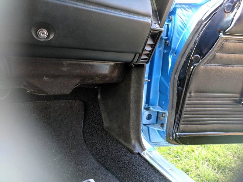

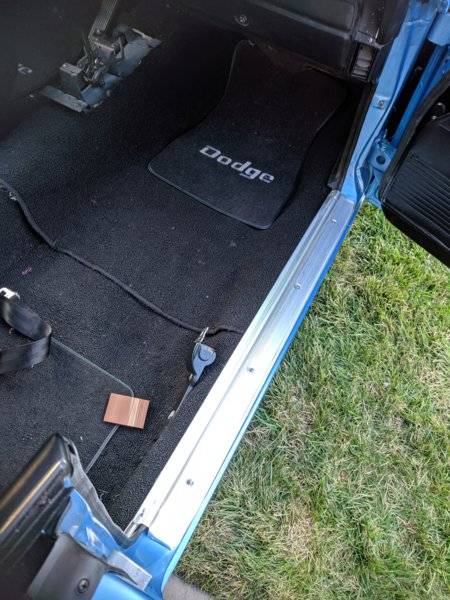

Cut the passenger side carpet and placed the kick panel in along with both sills.

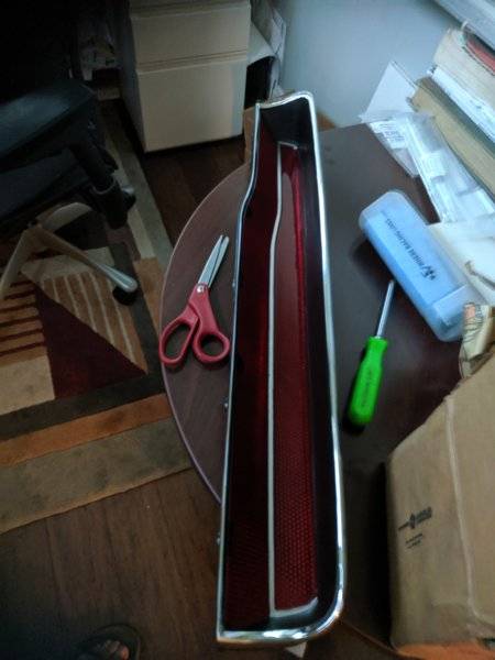

Also reattached the door handle linkage and installed the tail light cover panel
