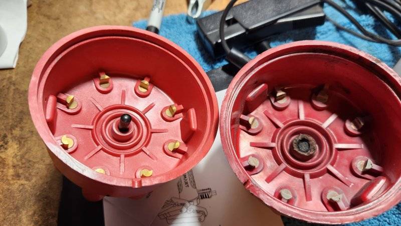

Your old cap was junk... I've seen caps like that before where the engine ran like crap... Adding timing made the engine run better... Putting a new cap on means you need to pull timing out in order to run right...
So there's actually a pretty good chance that cap was bad when you bought the car... The erosion of the plastic around the center electrode didn't happen overnight...
