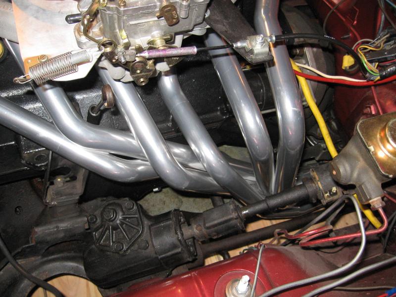

Is your engine a stroker? Maybe your engine builder sees a problem with not enough crank clearance. One engine I had the rod hit the dipstick. Had 2 sticks ,cut one short to plug the tube and put the other in the trunk to check the oil when needed. Just a thought. A spark plug boot holds a dip stick in on engines that like to push them out. I know,, don't laugh,,yes it is a Slant Six..Offset ground crank with aluminum rods.
