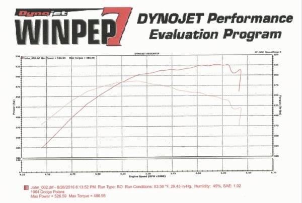

It almost seems like you're down a cylinder. Car should easily make 500rwhp on its worst day, even on a mustang dyno. Graph seems accurate, spread is correct between peaks. I'm just surprised the torque peak is so low (which is why the results are disappointing), even with 526ci, should be at least 750-1000 rpm higher (I would imagine). 380 cfm of airflow @ .700 lift, something is SERIOUSLY wrong here for it to have a torque peak @ 4100 rpm with max-wedge port heads. Converter seems way off for this combination.

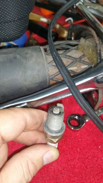

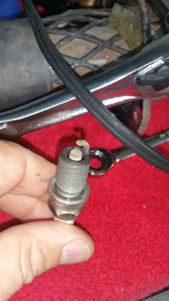

After everything cooled down I pulled all the plugs to see if I was down a cylinder and they all looked ok from what I could see. A little rich maybe but not horrible (see picture below). I really don't understand the numbers at all because everything is so far off. Besides the torque being early and low, the curve was nowhere near as flat as it should be. The converter was just built for this combo by Lenny at Ultimate with all the specs for the motor known ahead of time so based on his reputation I wouldn't think it would be that far off. We spec'd the converter for a 3800-4000 stall so it seems a little suspicious that this is where the dyno stops showing any additional gains. I'll call Lenny on Monday and see what he thinks. At this point I think I am just going to assume the test was completely bogus since I don't have any other indicators that something else is wrong. I'll run a leakdown test to be sure.

They did not but I don't think that is likely. If anything, reading the plugs it looks like the midrange might be a little lean.

Card reads 526HP at 6,000 and 487 Ft/lbs at 5350 ..........That engine needs a MUCH larger carb......
Larger carb will bring torque peak up and make HP a much flatter curve...

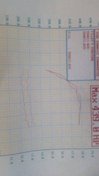

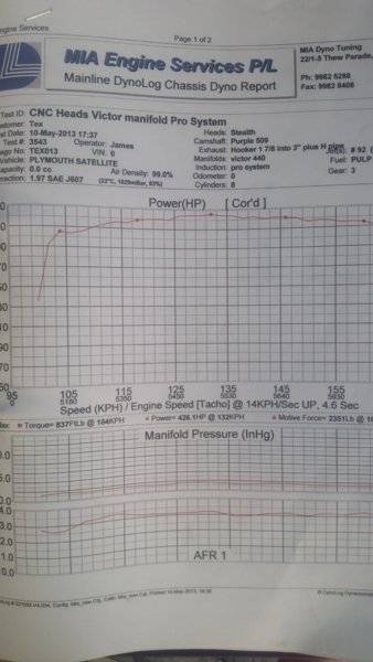

Heres a couple of my dyno runs .
MIA dyno in 2013 440ci
Tilleys Racing dyno 2017 505ci
Both pull till stall then flat but motor happily reved to self imposed redline . 6500 for 440 7000 for 505
Just an anomally that will show sometimes with autos
Tex
