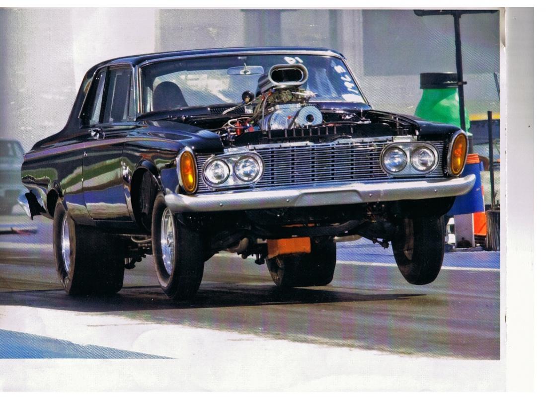

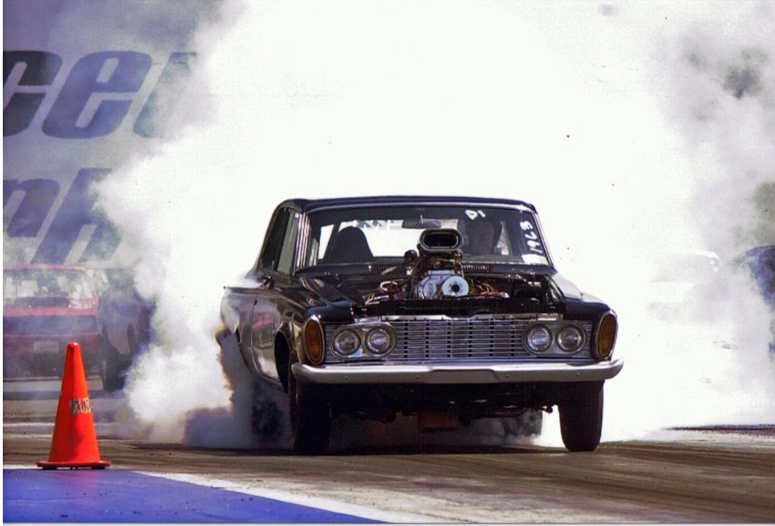

After doing my research,I purchased the SSBC basic kit.I like the fact the calipers are 4 piston,used my spindles and EVERYTHING I needed was in the box.Last coupla passes,my 3800 lb brick was 135 in the 1/4 without the white knuckles:munky2:
