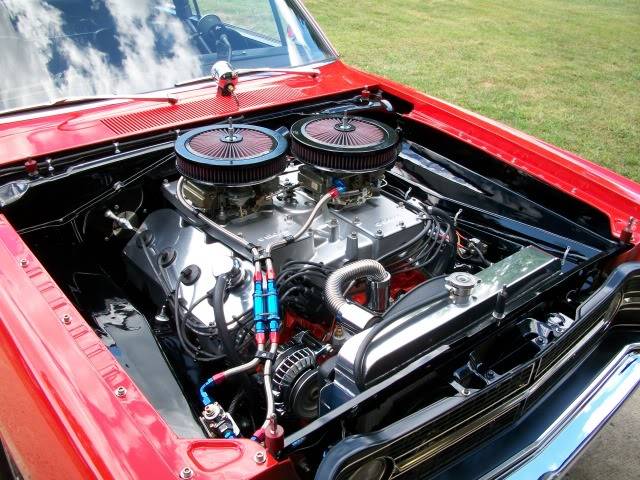

Sixpack slant-6…h'mm. Well, how 'bout six Briggs & Stratton lawnmower engine carburetors, one for each cylinder?
No! Wait! I got a better idea…how about six Mikuni carburetors? (The car in the pics is real. It's a '63 Dart. I've ridden in it. It's fast and loud.)
