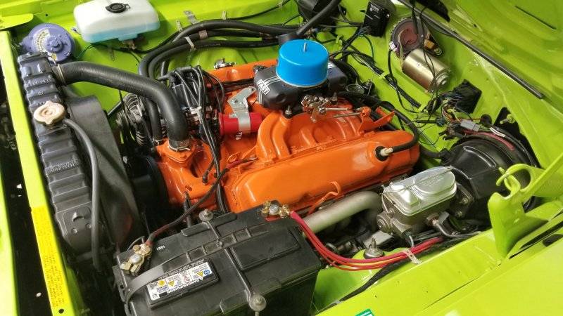

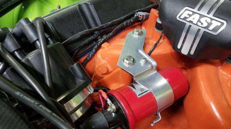

Edit: Here is a (not so great) picture of mine I use for my car. I have a FAST FI system with timing controlled by the computer.
P.S. Note that there can be clearance issues with many of these larger distributor housings. I had to clearance my head to allow this to fit.

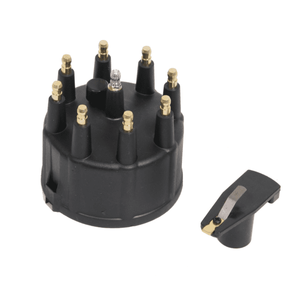

Summit has a hei style terminal cap for the standard Mopar aluminum case distributors.
Thanks - I was unaware such an item existed, so I stand corrected.
I've actually been searching for the reverse. I have an aftermarket distributor (in my case from F.A.S.T) and it has the GM style cap. I'd love to instead install an OEM style distributor. The problem is, my computer needs TWO timing signals.
One needs to trigger 8 times, once for each cylinder. This is easy since any electronic ignition distributor will do this.
But the other signal needs to trigger once every 360 degrees of distributor rotation.
So I'll say, I'm not aware of any distributor that will do this. I'd love to be corrected again if that is not true! :thumbsup:

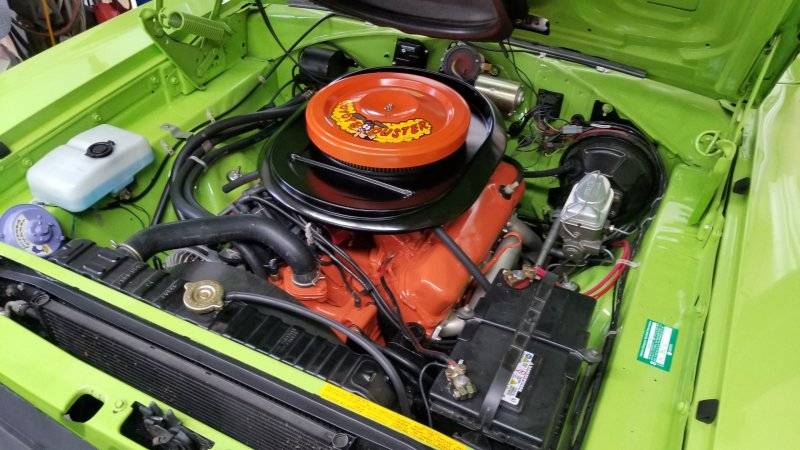

The "theme" of my car is to look as stock as possible - I don't want modifications to be obvious.
It has a fuel injected 500 cubic inch stoker engine, yet I have attempted to make it look (mostly) like a stock 383. All electronics, MSD boxes, etc., are all hidden under the dash. I've even tried to hide the A/C as much as possible.
