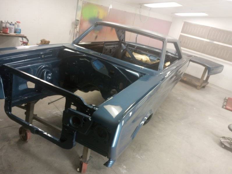

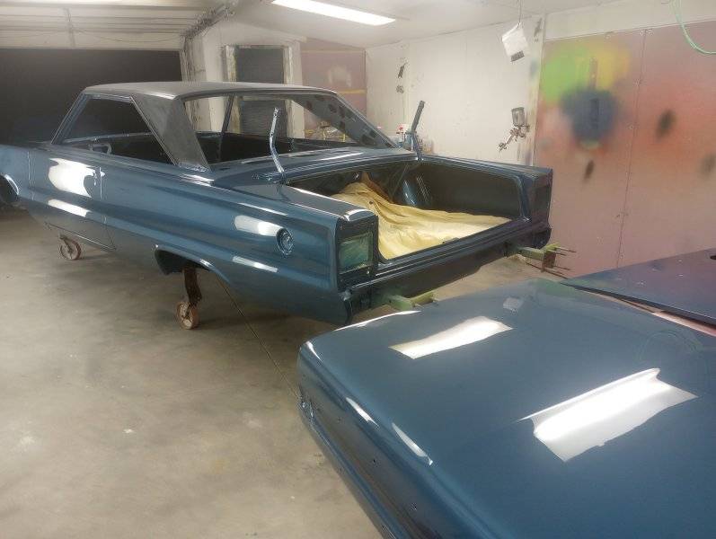

These are the ones I got for the roach. Dolly wheels (which I got at Harbor Freight) were not included.
Thanks RC! My friend was going to schit a brick when he sees the price of the Us Cartool ones! Those are much more reasonably priced.
My friend just ordered two sets of the auto twirlers brackets. Thanks RC,you da man!
