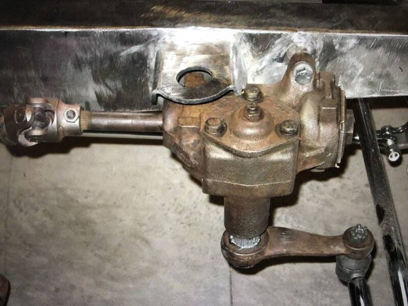

Vega's are front steer but the steering box is mounted so far forward the pitman arm comes out to the rear... So logic sez viewed from the top the shaft rotates counterclockwise when the wheel is turned to the right....
Not mine ,just sold my 31' Model a one week ago after 15 years of ownership. This is how you will see them on most early car builds. Right side of pic is the front of the car just to be clear. It's easier to see the rotation when you see the box indexed to the frame. The cross steer design helps a lot with bump steer, better then the more traditional F1 box.
@Dan64 was the steering connected to the spindles in front of the spines or behind the spindles?
Steering comes in from behind the spindles, trying to upload a different picture that shows more but site is not allowing me to currently.

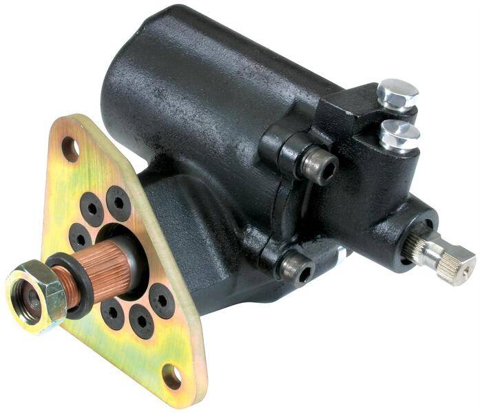

Specifically wanting to see which way and how the steering box/gear rotates the output shaft ....for research purposes of a new project.
Any help appreciated. :thumbsup:
Image of box I have in mind.... :xscuseless:
