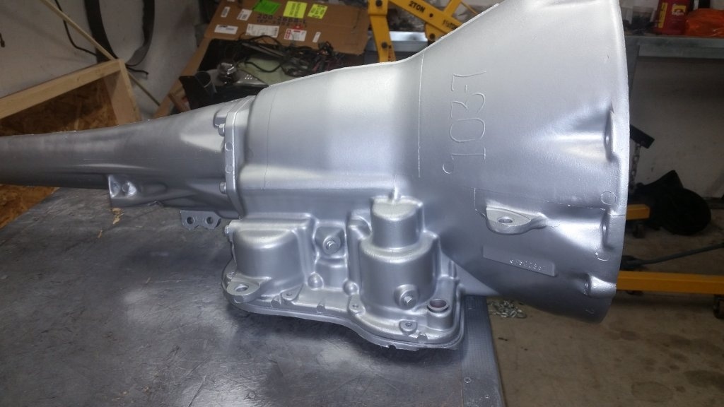

I use the high temp paint it sticks fine
Also they sell a high temp paint that looks like the cast alum it's a bit shiny but keep s things clean and oil wipes right off ,if you want a stock look

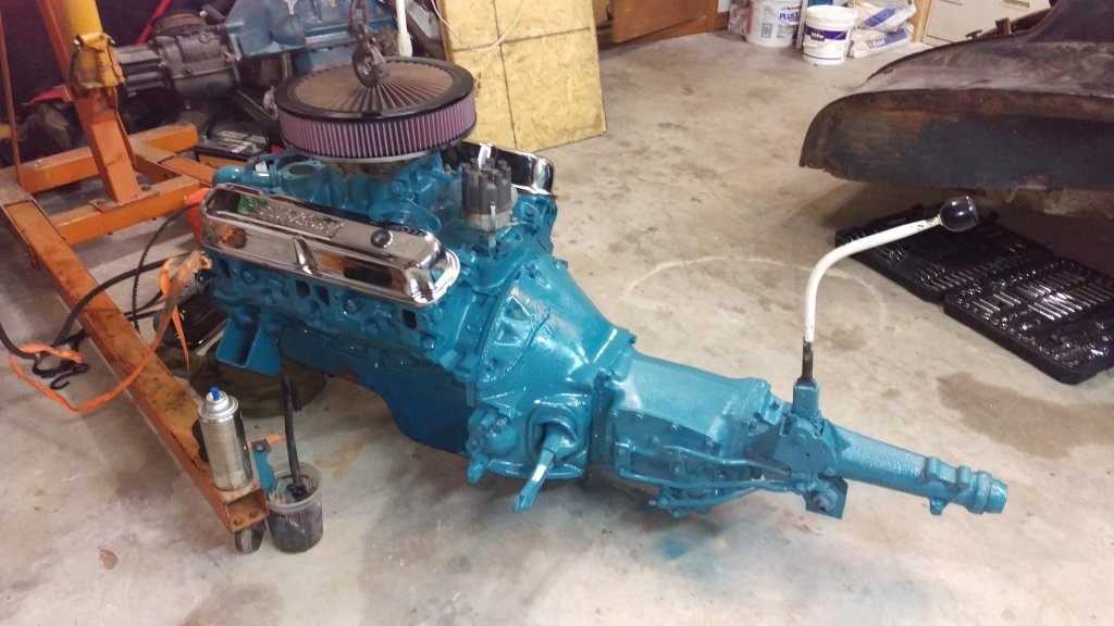

I went to mo-tech back in the 80's, the tranny guy there said not to paint the trans as stated above because of the heat issue, but with tranny coolers and if your not pushing a **** load of h.p. why not, have'nt had any issues with any cars except the paint peeling off. So I used brake caliper paint on mine, because its for high temps. I just cleaned the case with a wire wheel and wax and greased remover did the rest.

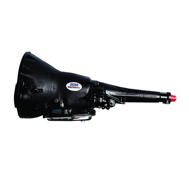

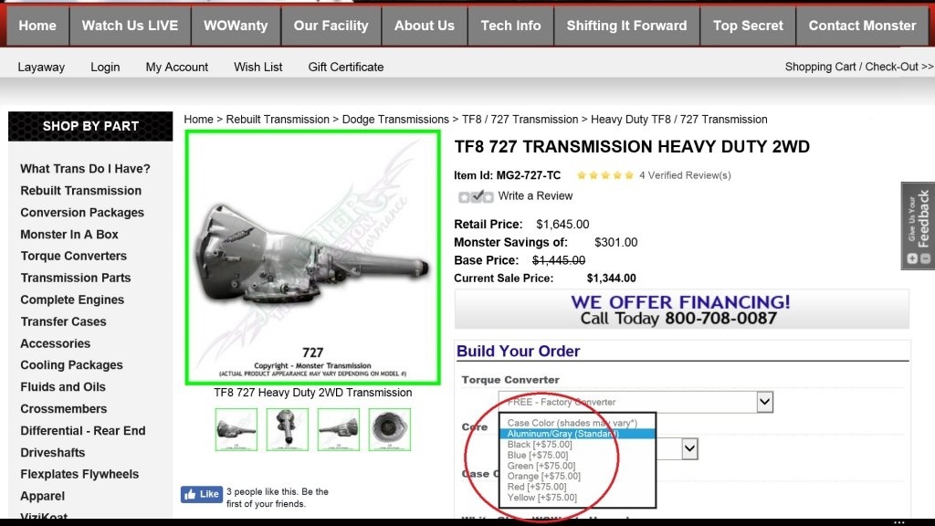

Monster transmission and most rebuild shops paint transmissions with warranties.
