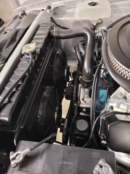

Well worked on the distributor set the mechanical advance and changed the springs to a little heavier, wow what a difference, plus adjusting the fuel injection to the correct afr ratios and prime shots. thing runs like a top. very nice just touching the key at any temperature and firing up and idling not touching the throttle at all. My fuel pressure is an 52 a little low for the recommended setting. gonna bump it to 56 and see what happens, dual electric fans set up to the fitech control pretty nice I can have it turn on and off at any temperature. Off to the lake tomorrow for final test and tune. she's nearly perfect.
