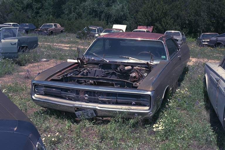

Here's a donor car I found in a local wrecking yard here in TX that I bought, and used many parts from; and lots of spares!

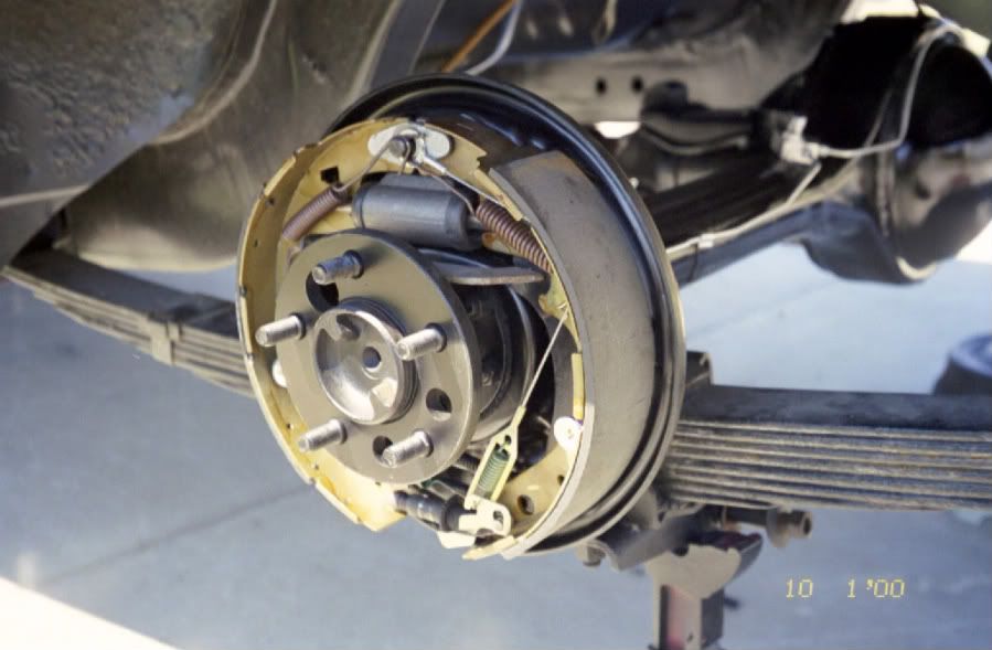

God, this picture was taken a long time ago to! Here I am with a recent Drum to Disc brake conversion I engineered myself in 2001 (?) from the donor car, and 73 Newport.

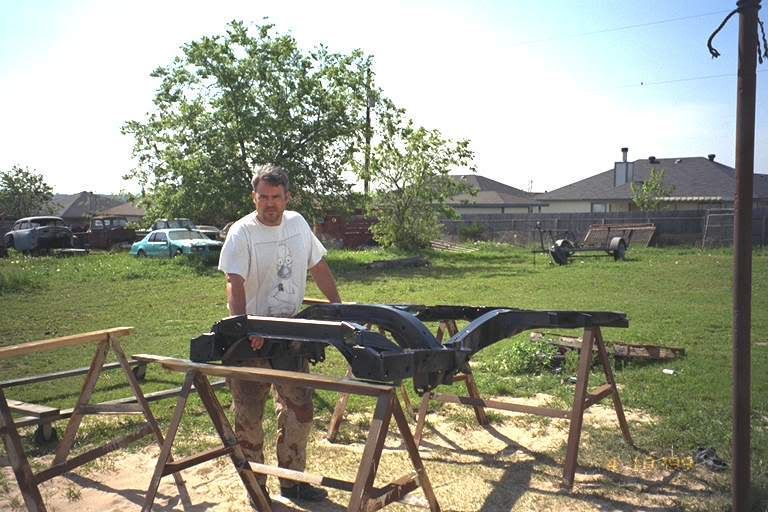

Needed a new frame (the C Bodies have a big, removable K Member type frame but it's HUGE!!! Here's the donor from the junkyard jewel!
