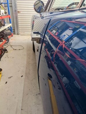

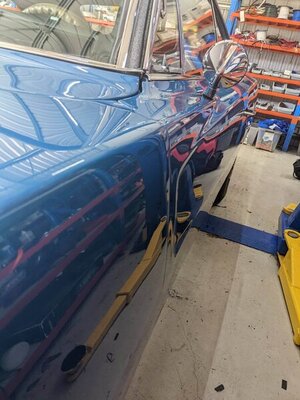

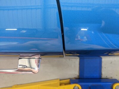

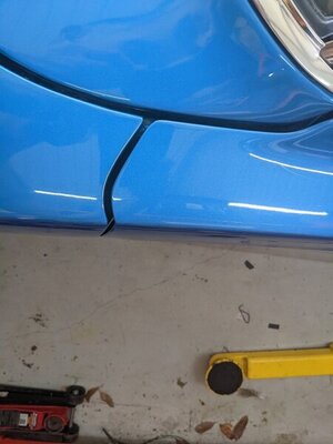

Hello all,
I need some help on how to get my doors aligned. Front is fine, rear not so much. I was going to start loosening hinge bolts but then I thought I'm sure there's a dark art to it. The alignment was never great to start with but since putting the electric windows in, it got worse. The gaps look good, just want the bodylines to be flush. Thanks for any help!
Chris
rsz_1pxl_20211214_062415078.jpg rsz_1pxl_20211214_062449714.jpg rsz_pxl_20211214_062445807.jpg rsz_pxl_20211214_062424862mp.jpg
Looks as though the striker has to move inward from the pics. There’s 3 screws, Phillips head, some may need an impact screwdriver and hammer. Loosen all 3, just a bit so the striker catch can move and just slide it in a bit, tighten the screws as no check.

A few suggestions....
1) put tape below and in front of the striker before you loosen the screws... That way you know exactly where it was & how much you moved it...
2) make sure the hinges are what locates the door, the striker shouldn't force the door upwards or pull the door down, it just holds the door in the jamb... I actually remove the striker while setting the hinges so the striker can't effect the height of the door...
3) Make sure the door latch clicks twice, it should have a secondary safety position & a second latch when the door is fully closed.... If it only clicks once the striker actually needs to be moved out, not in...
