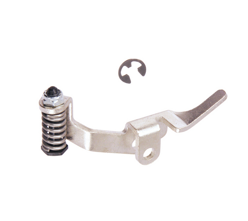

changing your Accelerator Discharge Pump & the proper colored acell. pump cam for your specific build/needs, will help also

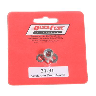

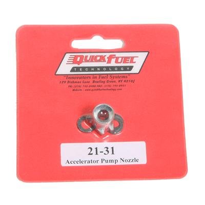

&/or also the Discharge "Squirters" Nozzles again must be properly sized, to get the full efficiency

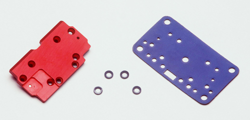

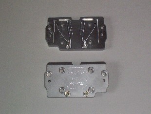

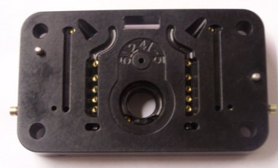

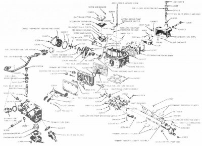

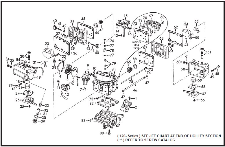

also changing your front bowl metering block with an adjustable Billet Quickfuel {my preferred choice}
or ProMax {my 2nd choice}, either of them will flow much better & are much better than the factory Holley Metering Blocks, they are adjustable too, unless you have one of the new Holley HP Series carbs or one of their race carbs...
It's relatively cheap, Changing the metering blocks, mainly so you can change air bleeds & emulsion bleeds, every engine needs it's own specific settings, what works on mine even if they are very similar, may not work perfectly on yours, they are all different, depends on elevation you live & drive in, the weather & your driving style/needs etc.
& going to an adjustable rear metering plate, with removable screw in reg. Holley type main jets like from

  • Quickfuel Billet Merering Plates adjutable replaceable jets for Vacuum Secondary.jpg
