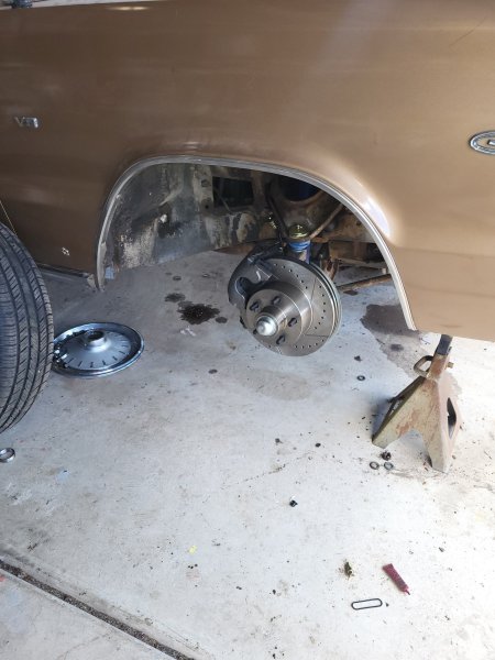

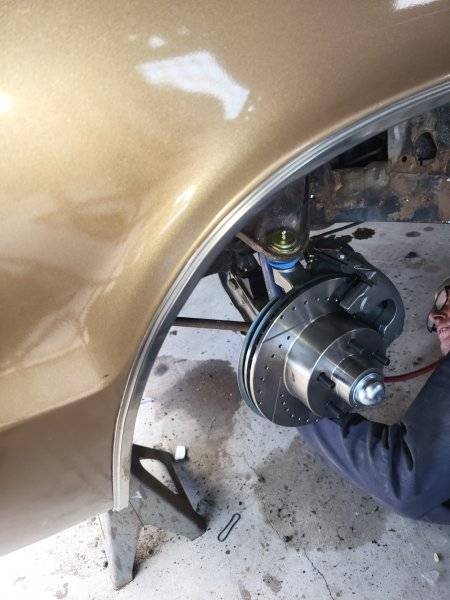

I'm converting a 1966 power drum brake car to power disc.
Using this kit.
So far...it's a piece of cake install.
I'll update you later in the week how it stops. Pedal height etc etc

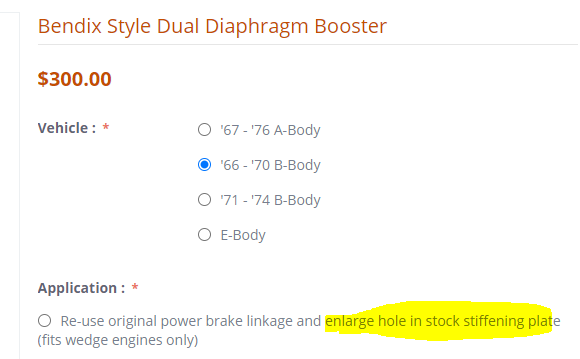

Those might be the only ones he is selling now. His original booster listing used to tout that no firewall modification is necessary. It was cheaper too. I paid $245 for his booster last year....he has them for $300 now so I'm assuming they are not the same ones..... His site listing do not say that either way. I would call him and ask the manufacturer of the boosters he's selling now.

Further looking on his site he now lists that you have to enlarge the hole.....so Im assuming hes not selling the defective ones he had originally anymore and these are the MBM ones.

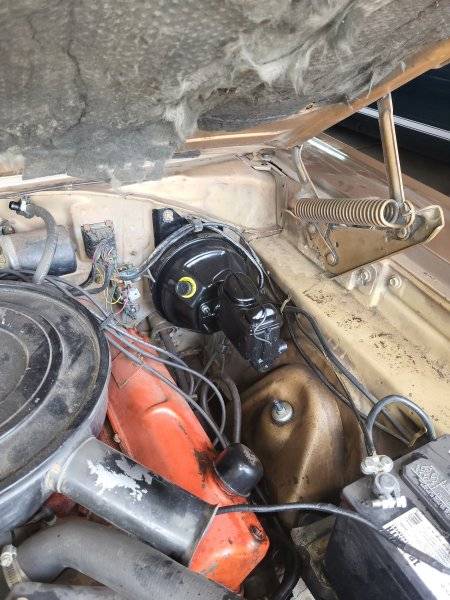

thanks a bunch. With this MDM Bendix style booster, does the brake pedal feel touchy with SUPER light effort? Mine does. I bought this Bendix style Dual diaphragm booster from Dr Diff about 4 months ago. I adjusted the push-rod gap to .020" using one of those special H-shaped tools and a feeler gauge and it's better, but still VERY light and a bit touchy compared to what I was expecting with a 1-1/8 Raybestos blue disc/drum Master Cylinder. If someone didn't tell me, I'd likely think I had a smaller bore 7/8" MC. The old booster I had in my car before was one of the gold colored dual diaphragm from Master Power Brakes. Not touchy at all, about the firmness I would expect with a 1-1/8" bore MC, but a little mushy even after numerous air bleeds. Both boosters stop the car just fine and could lock up the brakes and skid - I'd say the newer one from Dr Diff has greater stopping power overall. In the end, it's the pedal feel and modulation that I'm looking to fine tune.
