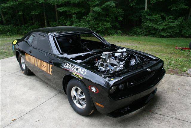

I've seen the TH 400s used in the Drag Pac cars, (Ford, GM, Dodge). They are very trick with very few stock parts. The non supercharged cars are still using 904 based stuff.
Doug
The 904 will work great with enough aftermarket parts. Still not equal to a 727 with the same level of aftermarket parts. Just less rotating mass.
The 904 stuff lives fine. Buddy runs 2 cars with them. New style Challengers, one stock eliminator (9.30 ), one in S/S (9.00). Both are close to 3400lbs.
Doug
Great, you made my point. If you have the correct parts they do the job.
The one I looked at had a Ford 9” rear axle as well.
Of course, it was all aftermarket, but 9” architecture, no less.
