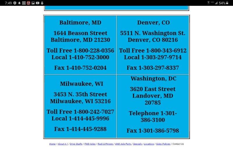

Hey Hubbard's,
You have an A1 Driveshaft in Wisconsin. I have used my local A1 here in Baltimore many times. They can build repair or balance them. All at a good price with very little wait
Check them out

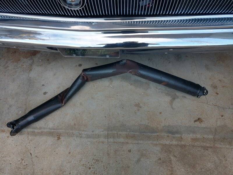

I twisted mine out of the car on the dyno
Tore up a lot of stuff underneath the car too

I had to replace the driveshaft, both yokes, a nearly brand new Exhaust including the electric cut-outs and one muffler
I also added a US Car Tool Drive shaft Loop
I learned my lesson

Lucky it didnt kill the trans and rearend too. (And check the sprag in the 727!)
I got lucky there
The car was up on the Dyno so the driveshaft dropped to the floor of the shop
Had it been on the street it would have bounced back and forth between the street and the bottom of the car and really did some damage
