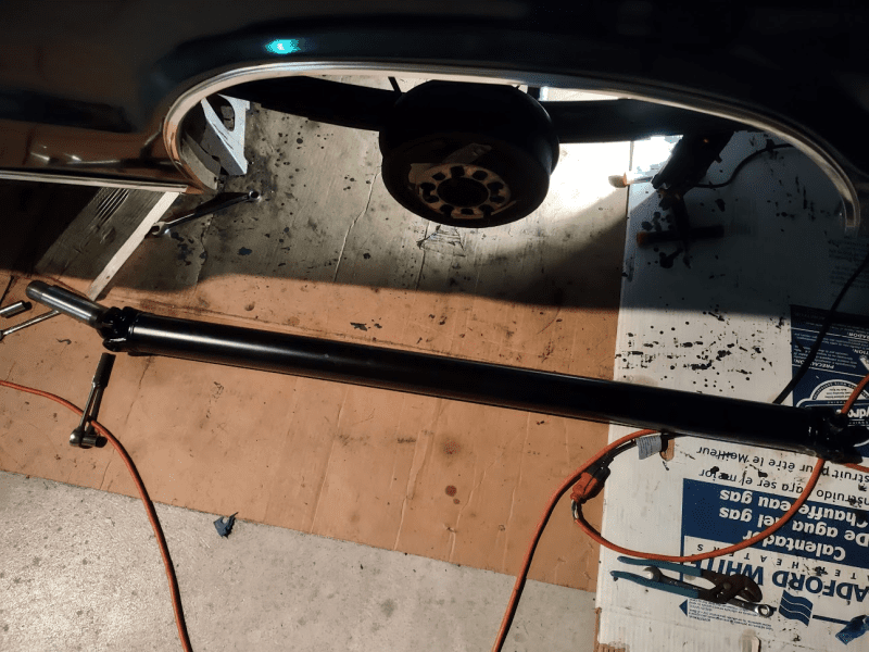

I have a 69 Charger with 727 trans and 8 3/4 rear, what other MOPAR driveshafts will interchange with this? I'm fairly certain that the GTX and RR and Superbee will, but what about the Coronets and Satellites, also what years
of these cars will interchange?
Tks,
Bob32268
Plymouth b body's have a 1" shorter wheel base, so you can eliminate thos. 67-70 dodge b body with 8.75 and 727 should be roughly the same...some years had the heavy ring cast in on tranny side
Lotta people don't realize or know that the wheel bases were different between several models of Dodge and Plymouth.
