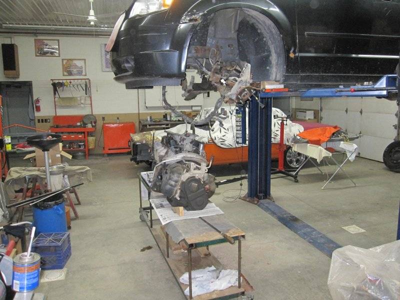

Chain hoist over the rafters, lift er up, roll drivetrain under on a jack, ( no drinking!) And drop the body down.
This would be easier.

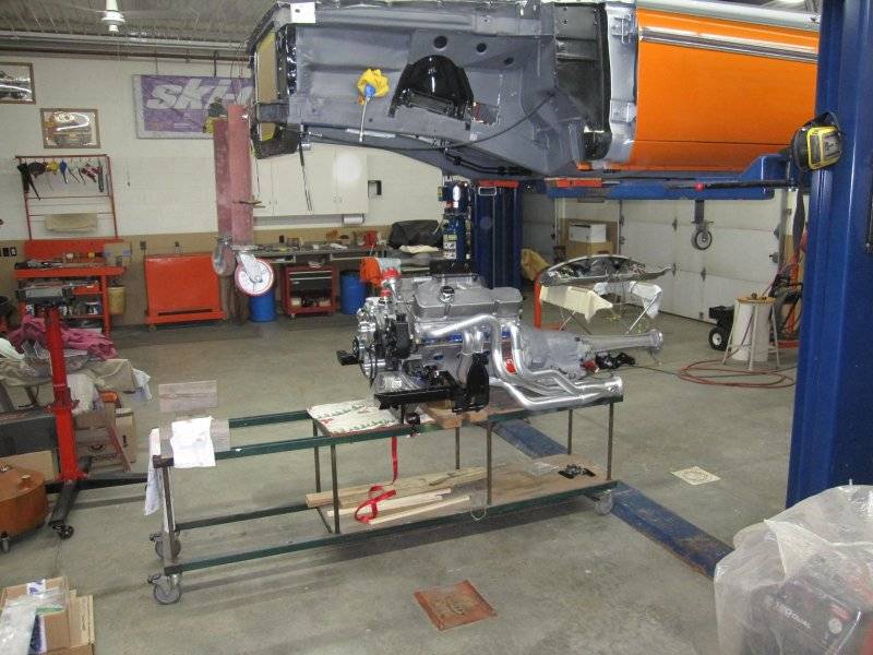

I have a two post and a cart I built (for snowmobile work) that worked like a charm. I used it on my 2008 Town & Country too.
Mike
Put it low on the floor and then raise the car off of it :D I've never done it that way but seems it wouldn't be hard to do with a cradle under it all.....
Wasn't thinking about the runways on a 4 post.....imo, they are going to be in the way.
4 post would be a p.i.t.a. I know it won't come down between the runners of my 4 post hoist. I never have a problem with just doing it from the top like normal with my electric chain hoist or with the picker if out in the driveway.

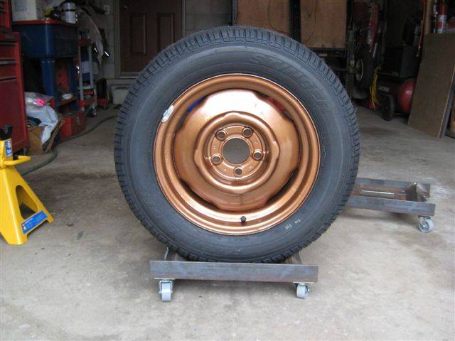

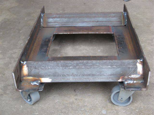

I built 4 of these years ago. They didn't work well for moving the car around because the casters were too small, but I should be able to bridge two of them to make a nice cart for supporting the engine and trans.
