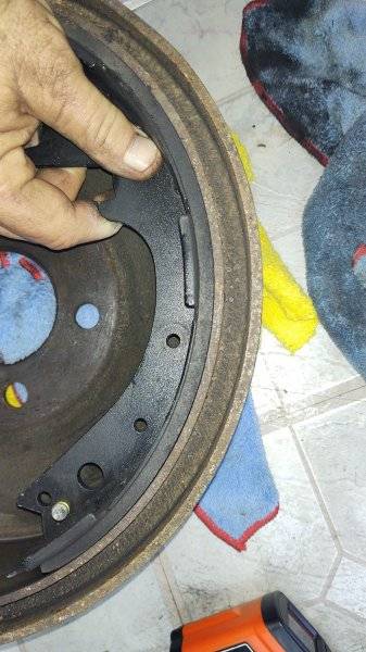

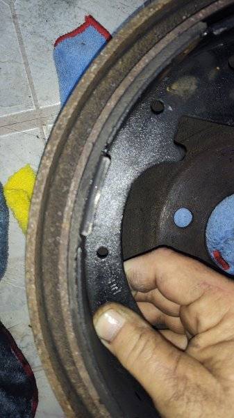

Once I got the LF shoes disassembled and off the car, some rudimentary inspections followed -
starting with seeing if they were arched anywhere near the same as the drum:
I realize this isn't a scientific, measured method, but they sure looked close enough for me.

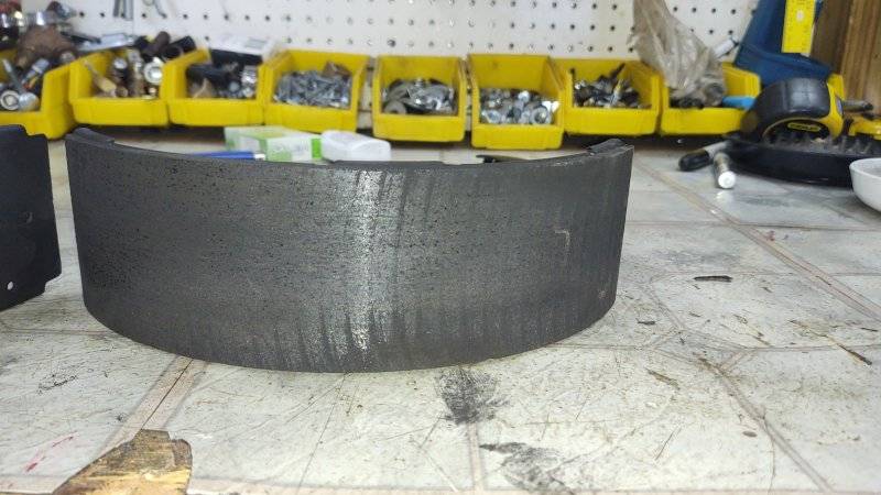

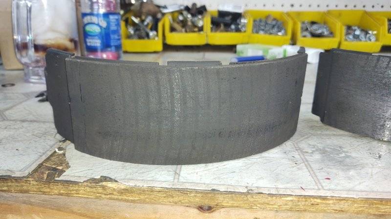

Finally, I went to town on the friction surfaces of both shoes with a rather aggressive, open-web sandpaper
and took off most of the checking/hazing/whatever that weird wear pattern was on them:
