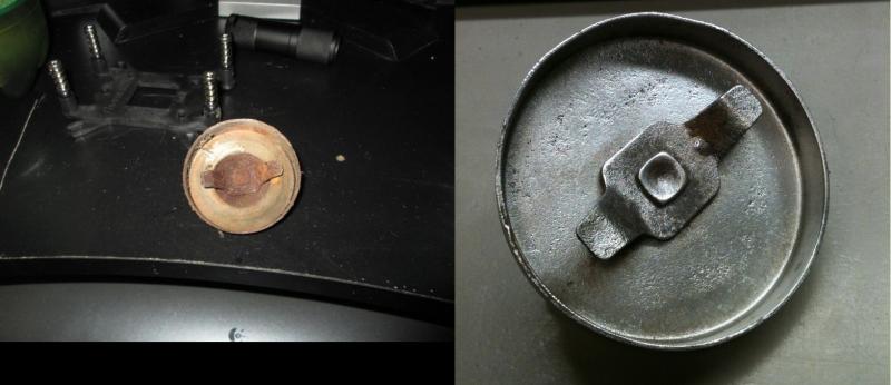

and to answer that... I'd ice blast individual components if they just need cleaned up.. I found the original gas cap to my Charger wedged in with the filler neck, ice blasting wouldn't touch it, but bead blasting did good on it
