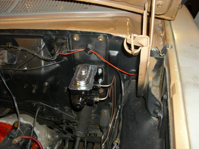

Hey Postman can you put up a picture of your master cylinder? I'm also having problems getting good petal, maybe the push rod is to short? I've bled the master a couple of times and the same with the wheels. How did you tell the rod was short or not hitting the end of stroke?
Hello Joe
The chamber to the Firewall is for the front brakes. the one in the front is connected to the rear brake.
I installed all lines new, new Wheel cylinders, Hoses etc...
I bleeded the master cylinder a few times too and tried to bleed the system, started at the right rear wheel. No juice arrived there, after "hours of pumping the pedal"
Then i tried it on the front. Fluid came and I had a very little presure under the pedal.
I thought, The pushrod was long enough, but it was'nt. so I ordered an adjustable one and I gave him only 8 to 10 Millimeters (Sorry, I'm German :)
That was enough! from here bleeding the sytem was no problem!!!
Open your wheel brake cylinders and push down the pedal. If it hits the floor, I think, you can be sure, your pushrod is to short.
If you need another pic, or I wrote something that is not to understand, let me know. I hope this helps!
Good luck!!
