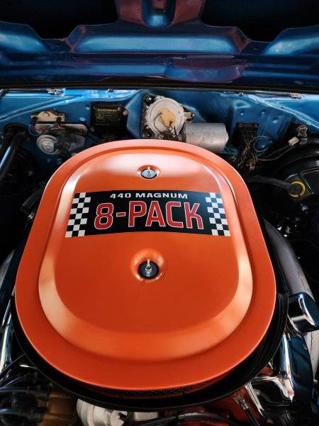

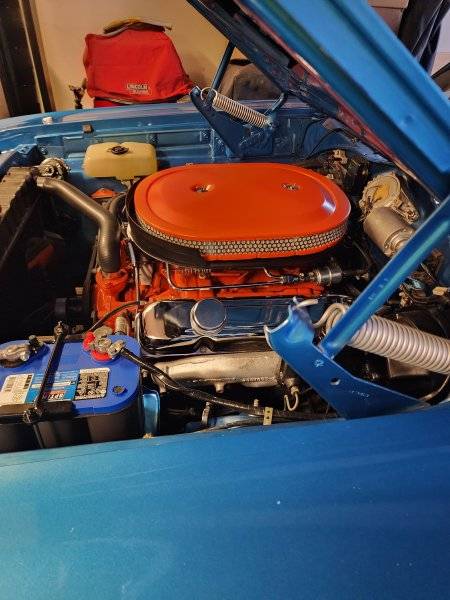

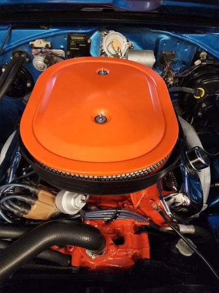

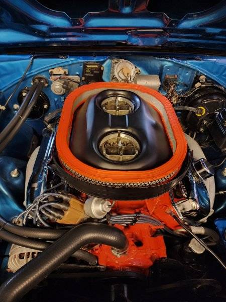

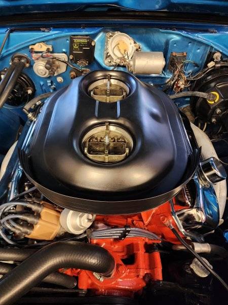

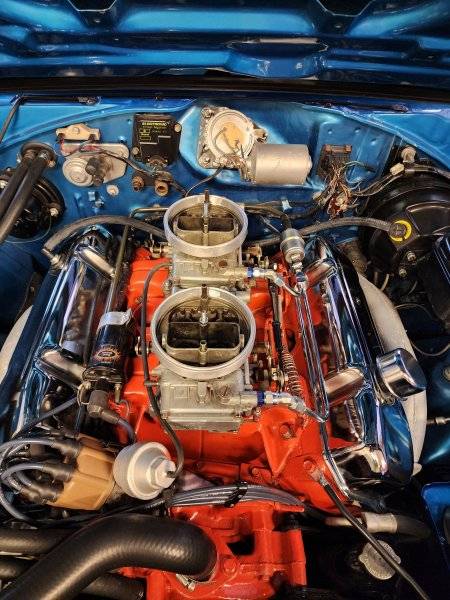

Got may air cleaner assembly from @Chryco. Had to make my fuel lines come in at a 45 degree angle to clear the base plate. The base plate also hit the rear fuel bowl on the left side. I used some .75" spacers on the air horns and everything bolted up.
View attachment 1567505View attachment 1567506
View attachment 1567507View attachment 1567508View attachment 1567509
Now i just need to get a larger 440 magnum 8 pack decal made

Looks nice.
How close is the lid to the base?
I'll try and get a measurement from lid to center line of the base plate today.
Just take off the air cleaner assembly, flip it over and check the gap. Your tightest pinch point will likely just as the base rolls down to the filter.
