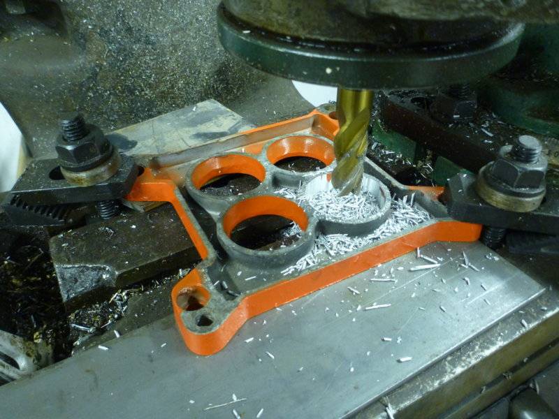

Why a 3/4" spacer? Certainly you can get buy with one thinner than that. The one I hogged out for the Bee to adapt my 750 holley to the stock manifold is only 3/8" thick... maybe it was a 1/2" but no more.
