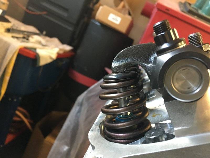

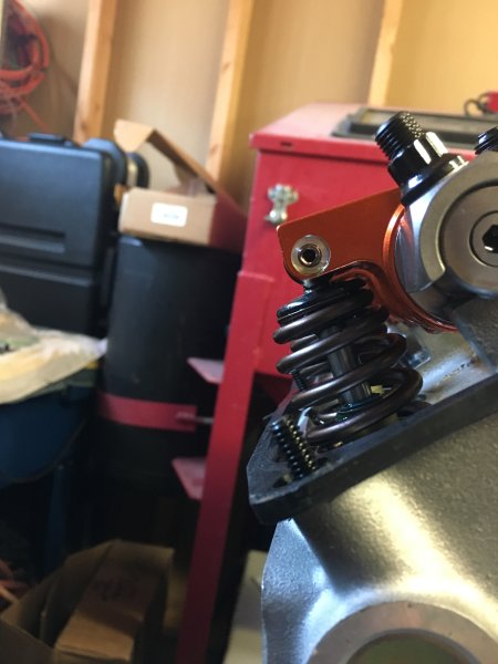

If you are planning on running Edelbock/Stealth/Trickflow heads, get the Harland sharp rockers that are designed to have correct tip geometry for those style heads ( SHPS70016KE or SHPS70015KE ) and save your sanity. Irons are a great budget choice for factory castings. B3 correction is a great way to spend double the money to solve a problem that Harland Sharp already solved without any extra BS.
This:
Not this:
Crane Irons on Stealth heads, Isky is same, note the rocker tip is way to the intake side of valve tip. It doesn’t get much better through the motion.
