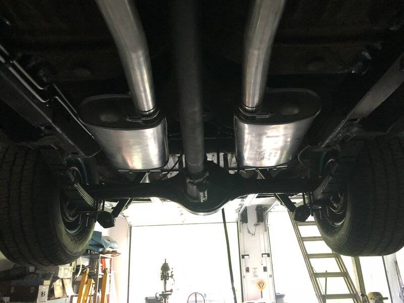

It wasn't too bad though things like replacing an exhaust system tend to be a little easier for me since I have a lift.
Anyway, the main hassle in my case was mating the headers to the exhaust. If you use any brand other than TTi for headers, you will have to make adapters to connect the collectors to the exhaust system. TTi does provide the extra tubing in the kit to do the job, it's a matter of measuring/cutting/welding the pieces and getting them oriented right which can be a little tricky. The rest of the system fit perfect, nice and level.
And a stick car to boot!! I've done several exhaust systems over the years without a lift. If you ain't old like me now, it's not all that hard to get the car up high and get to work but yeah, a lift always makes things easier.
These are Dynomax Super turbos 2 1/2" TTI pipes on a 440 with a .528 camshaft stock manifolds
TTI will substitute Ulta Flows for the Super Turbos in the kit if you didn't know. Perfect fit with no mods needed. There is a small upcharge, but not much.
