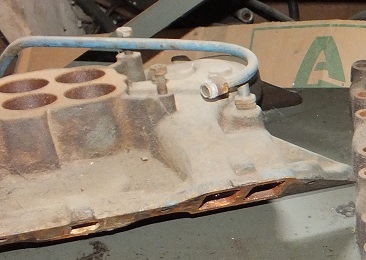

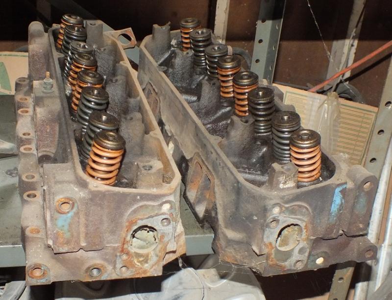

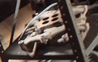

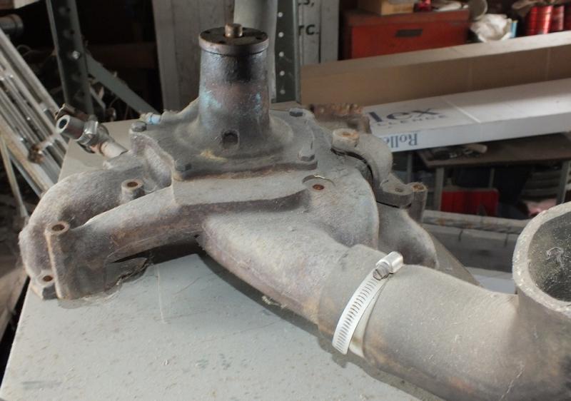

If it is a true motor home engine it will have a completely different water pump housing! It actually is plumbed in to the head,also the exhaust manifolds are different.If you use it get a pr.of earlier heads, closed chamber will bring the comp.up a bit! You can use the pass.car waterpump housing and heads will work on the MH block.
For anyone wondering here are some 413 Motor Home heads, water pump, and intake
440 motor home intake 2.jpg440 motor home intake.jpg440 motor home water pump and housing.jpg440 motor home heads.jpg
The 413 was the only motor offered in an industrial version in a motorhome, NOT the 440. Too many people make that mistake. The 440 in motorhomes NEVER had the industrial type bastard top end and water pump. Ever.
