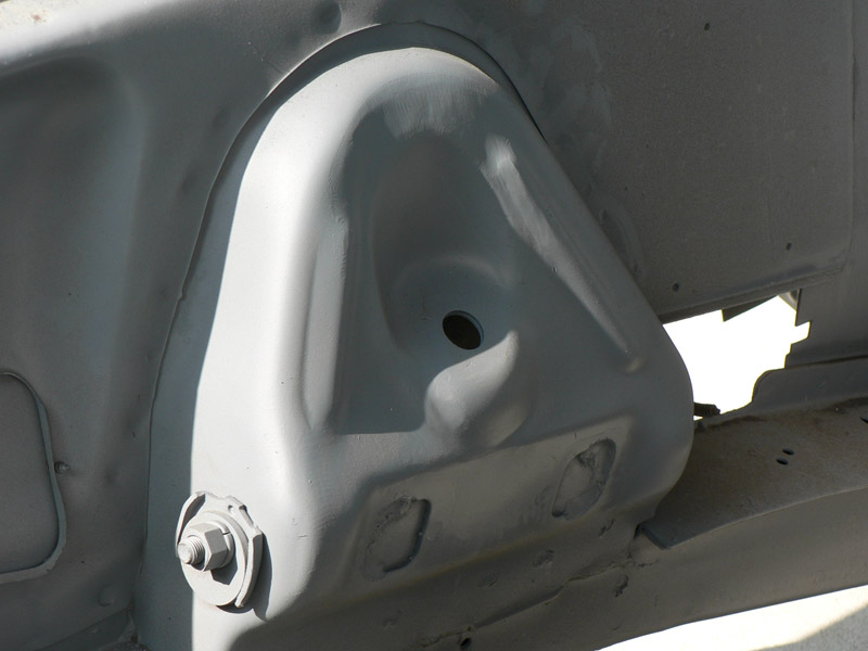

Either way, you might have to reverse the right hand shock tower as per factory mod.
Here's a pic of a modified right side shock tower in a 65 Coronet.

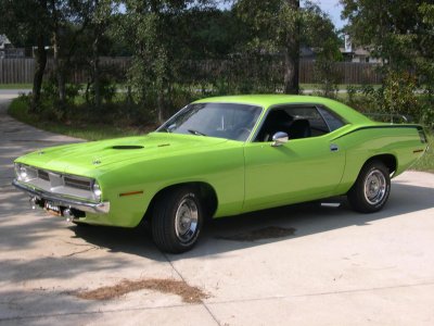

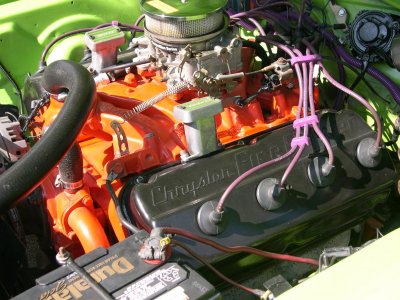

See photos ( 1970 CUDA ) 331 CHRYSLER HEMI
