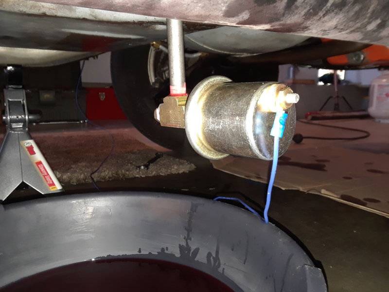

Checked line pressure on my 727, using my in dash oil pressure gauge, and a few pipe fittings. Worked great! Just so happens that the port on the tranny is 1/8 pipe, same as the oil pressure port off the engine. So I removed the gauge sending unit, and hooked a 3" pipe to the port on the tranny,an elbow, then a 6" pipe and another elbow. Screwed the sending unit into the elbow, hooked the wire to it, and the other end of the wire to the gauge. Worked great. By the way I'm getting 55 at idle, and 88 with the kickdown pulled back all the way. I think it's too low, so I'll be raising it......Also put a plug in the oil pressure port on the engine
Thanks! That helps. It looks I'm within FSM limits. The problem I'm having, is that it is shifting out of first at 4000 RPM, and out of second at 4500 RPM. I put a 5600 RPM governor in, which Raised the 2/3 up shift 500 RPM. So now I'm going to put in a stronger spring for the 1-2 shift valve, and a stronger spring to raise the line pressure and see if that helps.
