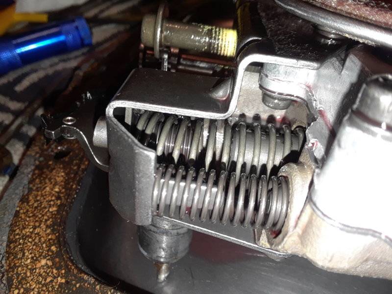

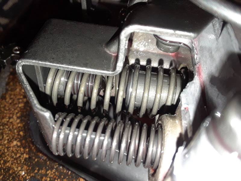

Ok Thanks! Spent the afternoon removing the valve body. What fun! Now I'll check the spring compressed length........ Looks like it is right at 1 9/16.....That's a quarter inch too long, although my line pressure checks within specs. Here's a pic of it. Looks like the adjustment is back all the way against the retainer.
And I think I see what you mean by adjusting the throttle pressure Gap at 5/8 of an inch. Now I don't know whether I should keep this stock spring in there and adjust it to its correct height, which would move it one-quarter inch shorter, or if I should put the heavy spring in that A&A is sending me.

Yes you did! The pics showing how to set the spring height was very helpful. I also have to set the throttle pressure adjustment, and the pics are helpful too , although I haven't tried it yet.

Oh really? I grew up over there. So I guess I need to know how to measure the throttle pressure distance without the tool. I held a steel ruler next to it, and it's hard to tell where I'm at. I'll send you a PM aeronet, maybe we can talk.
You have to compress that valve. So you need something that's 5/8. I'll go look in the garage and see if I can figure out what I did.
