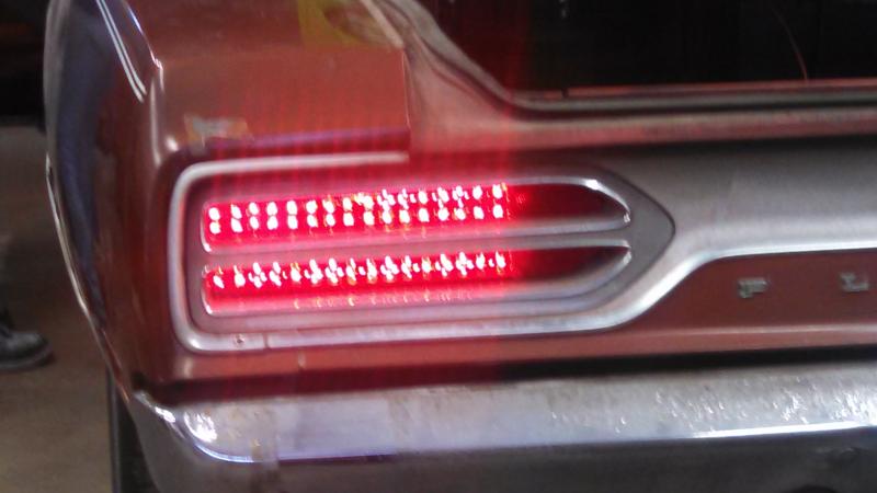

I got the digi-tails in my 70 and they are bright an work perfect. Turn signals are sequential. They are nice an they came with the led flasher module.
Here are the digi-tails.
