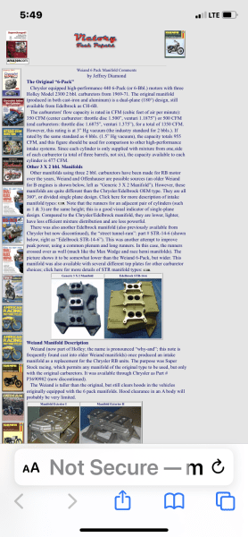

I’ll get back to ya once I find the artical
Victory tech papers

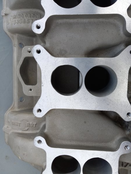

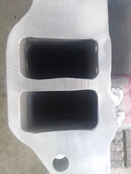

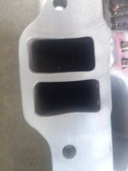

Do you have the manifold?
I have two. The original A12 is very nice, the much newer over the counter manifold has terrible core shift, and nasty misshapen port openings.
I see you're planning on a port match,, it'll need it,, and check the carb throats. They aren't round, and the core shift leaves a ledge that has to be blended out.
Thanks for the heads up, I will study that closely
Wow! Those look like "seconds" that were headed to melt down.
Mike
Well, I was given to me, free. But that was because of the failed attempt to plumb it for a concealed nitrous kit. It needs some welding, and some grinding, (and some carbs, unfortunately) but the price was right!
