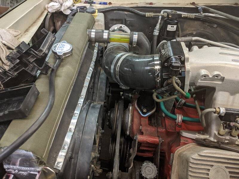

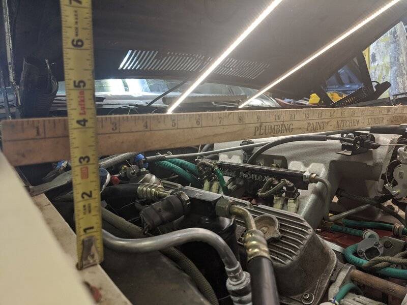

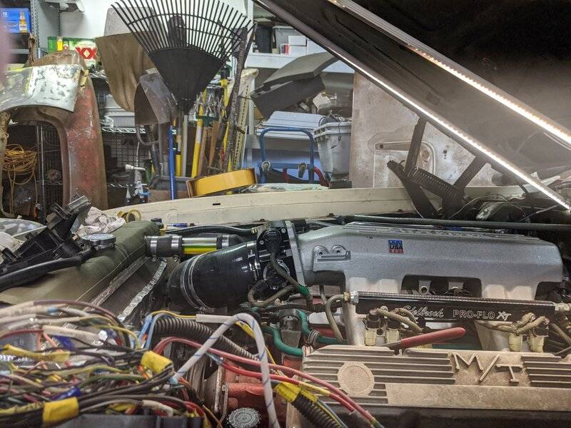

I run that manifold on my 71 RR and it clears no problem. I think the inner fenders are close so hear is a measurement. 3 1/8 hi from the top of the inner fender and that is 25 1/2 from the firewall.
Like 451 said the TB is right above the tstat and my intake elbow came out to close to my fan and shroud so I had to go to electric fans.

What controller are you using? I see you have a Holley Throttle body.
I had a hard time finding the correct size adaptor from the 4" inlet tube to the throttle body. I got if off E-Bay many years ago.
I'm using Holley Terminator, that I've rewired to seq efi, and that is the Holley TB because I like the tapered bore around the throttle blade and it does have 4" inlet flange.
