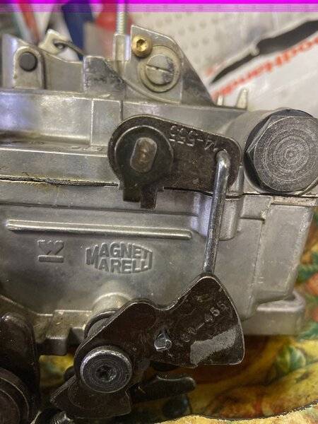

So I ran across an Edelbrock carb and the numbers on the front left pad are h13s 1180. anyone know what this thing is?:cursin:
Thanks in advance!!!
Probably a date code. AFB or QJ? Did you check all the mounting pads?

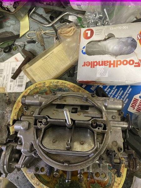

Pictures added, magneti marelli Edelbrock, whatever that is. Any other ideas?
AVS Top - Edelbrock Thunder Series - Black linkage

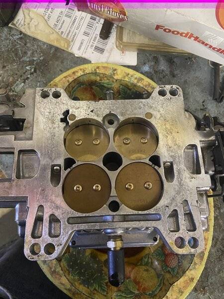

Flip it over so we can see the bottom base plate throttle blades for size
If pri & sec t/bores are 1 3/4", then it is 800 cfm. If sec bores are 1 3/4" with smaller pri bores, then it is 650 cfm. 500 cfm will be smaller still. Only three models.
