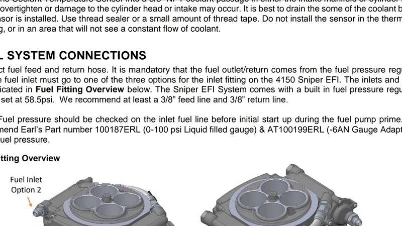

Holley recommends at least 3/8" feed and return line size with their Sniper EFI.
Seems they do, but it's not needed.
If you wanted to test if the return line is large enough, loop the feed line to the return with no regulator, run the pump and measure system pressure (if there is any). That's 100% re-circulation and minimum possible pressure.
If that is less than what your base fuel pressure will be, a larger return line will do nothing.
