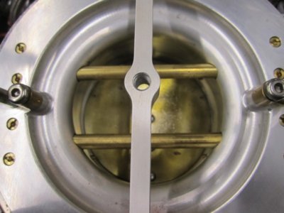

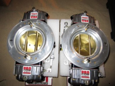

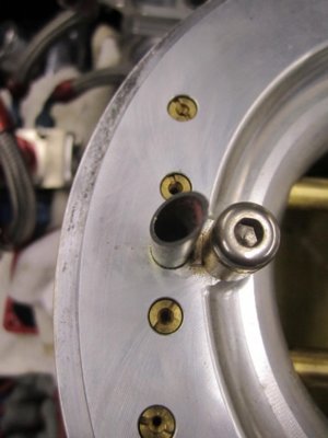

I liked the SV1 carb so much I use 2:jackoff:They were 1200 each at the time,but the EFI system was over $:wtf::screwy:6000
I might have a few ponies more,,,,,,,,,your results may vary:blah::blah::blah:
10.23.15 009.jpg SV1!!!!!!!!!! 003.JPG SV1!!!!!!!!!! 004.JPG SV1'S 018.jpg 3.6.14 035.jpg 3.6.14 037.jpg 3.6.14 040.jpg 3.21.16 012.jpg 5.13.15 005.jpg 7.15.12 (15).jpg
